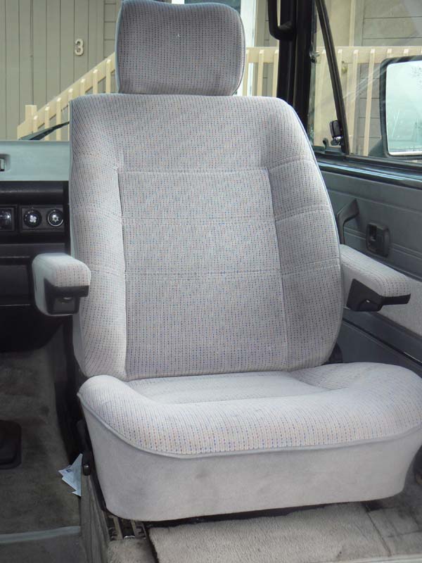

PostPosted: Mon Dec 20, 2010 3:34 pm    Post subject: Eurovan seats in a vanagon Reply with quote
I just did this today. Many thanks to whoever discovered that they can fit fairly easily.
It took maybe an hour to cut the extra lip off the eurovan tracks. Just aim the grinder (with a thin metal cutting wheel) in the corner where the extra lip sticks down. It takes about 10-15 min each track x 4 tracks. The seats look awesome. After doing it, they slide in perfectly and it now seems silly that I spent any time at all trying to clean up the old original 87 seats I had in there. It makes sense to buy a very good set of Eurovan seats if you are going to do this.

PostPosted: Sat Dec 25, 2010 9:45 am    Post subject: Pics of eurovan seats in a vanagon Reply with quote
My first try at posting a link to photos. I see other people posted photos in the gallery section of eurovan seats in a vanagon, so no new ground here, just my 2 cents.
I am happy with them, you do sit up higher but that is going from a Westy that has shorter seats to Eurovan passenger seats. The Vanagon passenger seats are also taller than a vanagon westy. Anyway, you notice it and the wheel is closer to your legs, but they work fine for me. The larger seat base is a huge improvement in leg support and comfort.
The last photos is what you cut off the eurovan tracks.

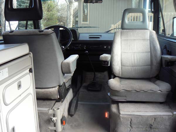

PostPosted: Wed Jan 16, 2013 7:44 am    Post subject: Reply with quote
For those who have not had the chance to compare, here’s a look at the difference between an '86 GL Vanagon seat (the brown one) and a '93 Eurovan seat (the blue one). Both of these are shown in my '87 Westy and are in place of the stock Westy seats. I had already installed the EV seats in my van because I could never find regular GL seats. The stock Westy seats were in great original condition but were extremely uncomfortable. I later found these GL seats and grabbed them for resale. If they’d been grey I’d have sold the EV seats instead, but that’s life. Here you can see that both have good bolsters for good support and they appear similar. Both are vastly more comfy than Westy seats, and both are shown as installed on the stock seat swivels. The EV seat did require minor surgery to the rails in order to fit and that is well documented elsewhere, but the GL seat simply slid into place.

PostPosted: Thu Jan 17, 2013 10:02 am    Post subject: Reply with quote
Is the eurovan seat higher than the stock non westy vanagon seat? It doesn't look like it in your photo, but my initial impression without measuring them, was that the non westy seat is higher than the westy seat and the eurovan seat is higher still. Since you had them side by side, maybe you can settle that.
The EV seat is 1/2" taller than a non westy seat from what i measured long ago.
