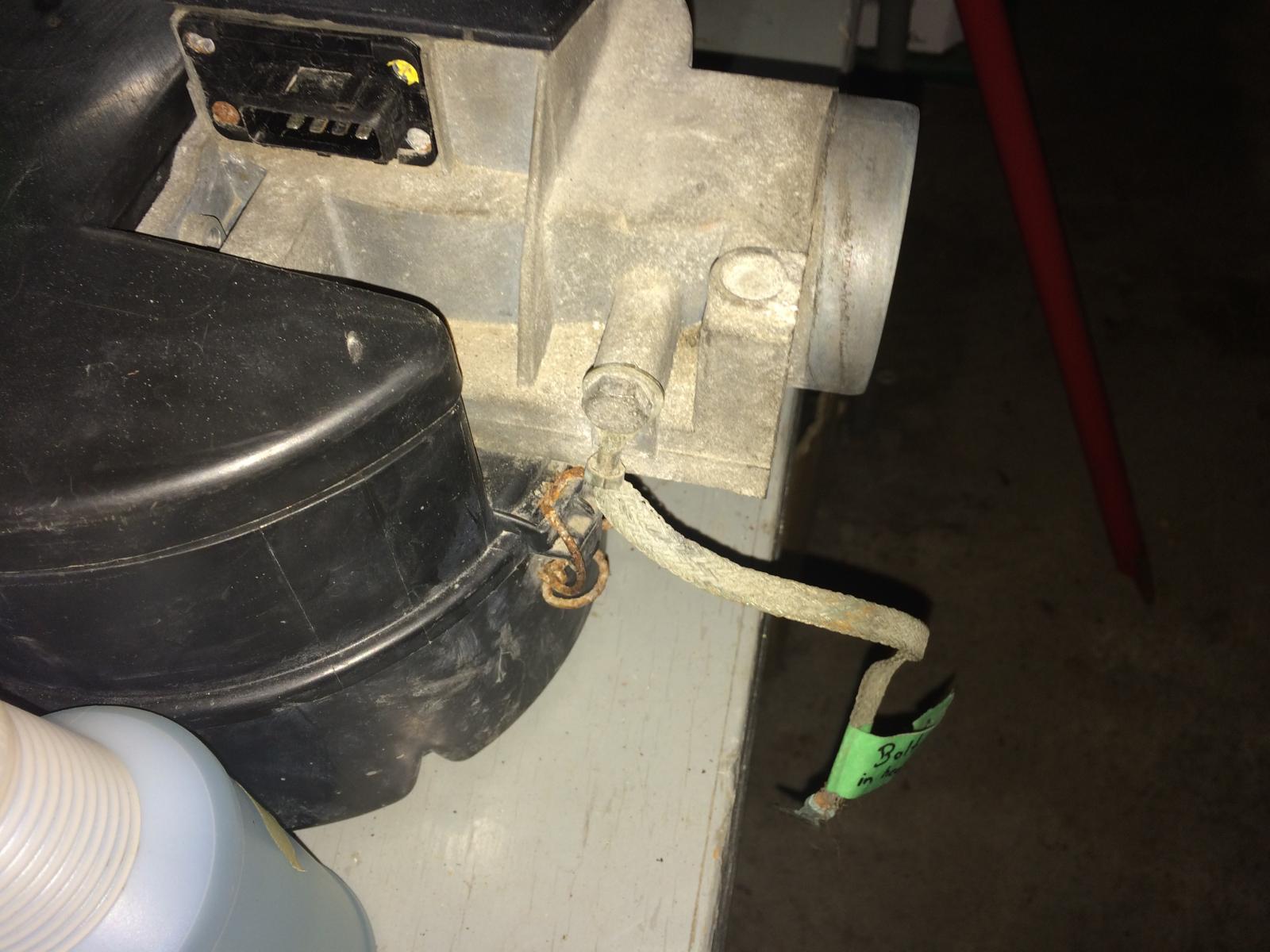

I was reading this on the bus enroute home and recalled seeing a ground strap on my 1990 connecting the afm housing to the passenger side head. The afm "pigtail" came with the van as well.
The air intake housing is off the van because we are renewing fuel lines so here is a picture of it in the workshop that I just took when I got in the door. Not a direct answer to the OP's question, but it got me thinking about what the pigtail harness was for and maybe VW thought adding this strap was helpful in maintaining a clean signal.
