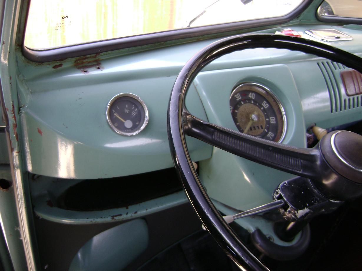

PostPosted: Sun Dec 26, 2010 8:34 am    Post subject: Reply with quote
Bought this dash that came from CA. I was told it was from a 1957 bus.
My question : Is this a 57 dash and will it work for my 1959 kombi?
I don't see any differences between two.

^^^^^^that is a beautiful dash!
