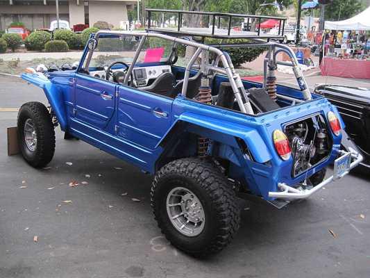

Well My hope is to take possession of my Thing around the first of the year. With that said Ive been looking at what I want to achieve as soon as possible after I get it. It has already been lifted, the adjustable front beam installed as well as after market 2" longer arms on the back. While my intent is to keep this a 60 Percent on road and a 40 percent off road car there are a few things that I have seen that I really like that have not been executed as of yet.
The original fenders are gone and new plastic fenders are waiting to be installed. I saw only one pic of this blue Thing on line and I think it is the direction Id like to go with mine. My question is for those of you that have them already what would be involved with raising the fenders to a similar height as these? Mine is a 73 so the boxes are not an issue. Body trimming? Moving things around inside the body for any reason? Thanks in advance so I can be making some plans.

On the photo you posted it looks like body cutting front and rear, and cutting of stock fenders. It kind of looks like the fenders were tack welded to the body after paint.

I don't see much body cuttin on the blue one... Just a little on the rear 1/4 panel....
Looks like the Thing "Baja" style front fenders, trimmed to a flat style...
Rears look like wider glass, just mounted up higher on the body...
There is a thread here "After 20yrs, a Thing".... Or something like that... He's done close to the same thing, but kept the fenders full...
Love the look, and it looks Very functional!! Cool

[quote="GI Joe"]I don't see much body cuttin on the blue one... Just a little on the rear 1/4 panel....
quote]
Take another look at that photo, look across the hood at how high the driver side front fender is and compare it to yours or any other stock thing. The body metal below the fender has all been removed.

http://www.kustom1warehouse.net/Prerunner_fenders_for_VW_Volkswagen_Thing_p/thingfenders.htm
Here are the fenders.... Prerunner style.. They sit about 4" taller than stock(but mount to the stock locations...)..
It's an optical illusions guys! I stand by that the blue Thing posted above is Not cut in the front... Wink
From Shoyrrt's thread(also a SoCal guy)..
Ok, I'm guessing the fenders on the blue one are one offs... They sit even higher than the ore runner style.... But I still beleive the body is uncut... Rolling Eyes

You are right, it is an optical illusion. I didn't realize that the add on fenders jutted up.

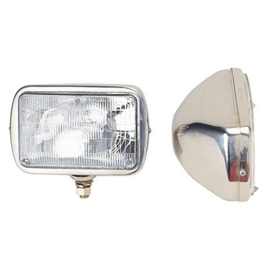

These are the high low beam head lights I was thinking of using on the street. For off road I will run an assortment of LED's...
http://www.speedwaymotors.com/Rectangular-Headlights-Halogen-Bulb,35742.html
