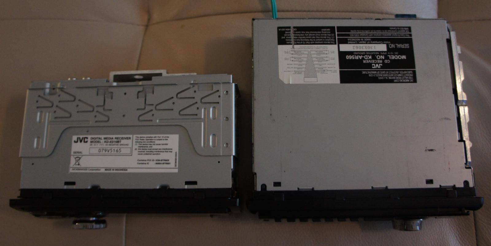

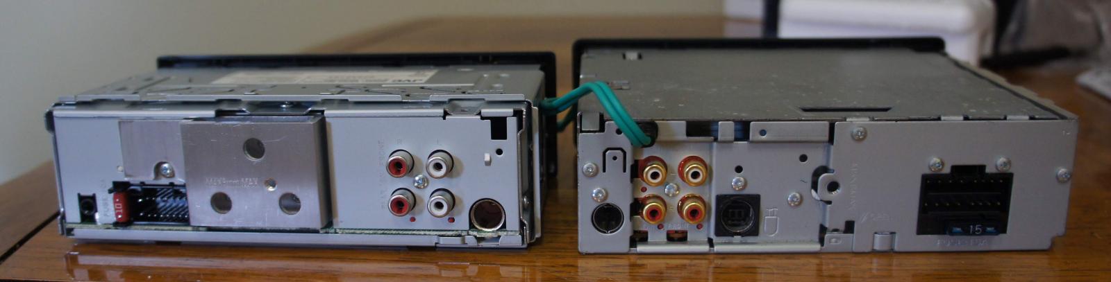

It thought it was about time to upgrade the stereo head unit in the Westy after 6+ years.
Back in '08, I installed a pretty nice system at the time: JVC KD-AR560 head unit http://support.jvc.com/consumer/product.jsp?modelId=MODL027430&page=3 with a CH-X1500 12 disk CD Changer http://support.jvc.com/consumer/product.jsp?modelId=MODL027020.
Most of my music collection at the time was in Mp3 format and this head unit and changer supported Mp3 disks.
The head unit drove 5 1/2" (F) and 6x9" (R) speaker in the doors with the changer on the side wall of the cabinet behind the drivers seat.
I also have a power amp inside the closet and that drives 4 speakers in the back (large bookshelf speaker under the bench seat and smaller ones in the roof cabinet)

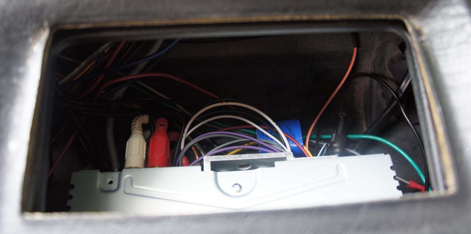

But there has always been an issue with the limited depth for the radio because of the heater box. Like most everyone else, I ended up having to fad a 1/2" stand-away to move the whole unit forward.
Well time and technology move forward and new and better units with better features have become available. By 2014 my whole music collection had gone digital and keeping any of it on a physical media (ie: CD) was long gone.
Time to upgrade
I was very intrigued by the new 'Digital Media Receivers': No CD drive (shallower depth so the heater/interference problem solved), support for Bluetooth (wireless!!!) and USB (capacity solved).
I looked at Alpine/Pioneer/Sony/Kenwood/JVC and more.

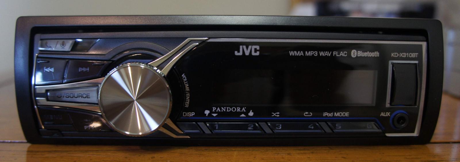

I ended up on another JVC product: KD-X310BT unit http://mobile.jvc.com/product.jsp?modelId=MODL029327&pathId=139&page=1 mostly because I've always had good luck with JVD in the past, the USB port is in the front, it has a lot of adjustments controls to the unit built in and the cost was very reasonable (approx $100 delivered)
It supports: android & apple apps, Pandora & iHeart Radio (dont use either), WAV/MP3/WMA/FLAC/iPod & iPhone Audio and still has 4 RCA jacks the back for my power amp.. Below are some pictures of the before and after and differences between the two.
Right now I'm just using a small 8GB USB drive I had laying around but its enough for 75+ albums / 850+ songs but I can see getting a SanDisk Cruzer Fit 32 GB (about $20) in the near future.... tiny enough to easily blend into the unit and tons of space ... Mmmm) http://www.newegg.com/Product/Product.aspx?Item=9SIA12K0F13323
(if anyone is interested in the old head unit and changer, let me know... otherwise it's headed to 'flea-bay')
