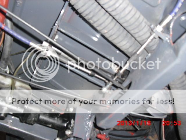

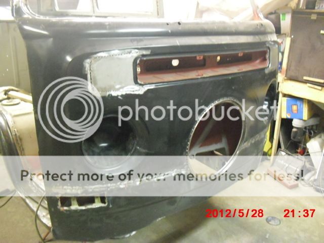

PostPosted: Sat Jan 02, 2016 3:07 pm    Post subject: Re: Subaru conversion cooling/radiator suggestions/ideas. Reply with quote
like this maybe

jokgel that front end install looks great. What are you using for coolant lines?

Nice job, very similar to what I had in mind. Wink
jokgel wrote:
like this maybe

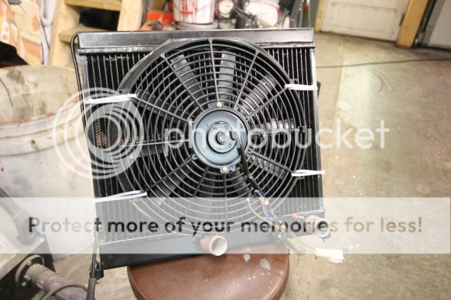

PostPosted: Sun Jan 03, 2016 8:04 am    Post subject: Re: Subaru conversion cooling/radiator suggestions/ideas. Reply with quote
I use 32mm rubber hose with Amering . The first time I did a Citroen Berlingo radiator used . After mounting the winch I had to use a self-made .
Radiator from citroen berlingo you can rotate 90 degrees . And the two terminals are on one side . Passing between the frame

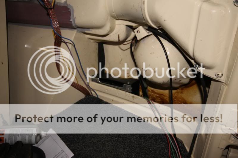

PostPosted: Sun Jan 03, 2016 8:15 am    Post subject: Re: Subaru conversion cooling/radiator suggestions/ideas. Reply with quote
looks like this .

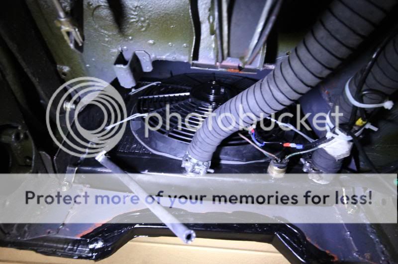

PostPosted: Sun Jan 03, 2016 8:32 am    Post subject: Re: Subaru conversion cooling/radiator suggestions/ideas. Reply with quote
I still have a few old pictures found Rolling Eyes

jokgel that is great setup. I imagine it works very well. Not sure I'm ready to tackle that much fab work. Thanks for sharing.

PostPosted: Sun Jan 03, 2016 11:20 am    Post subject: Re: Subaru conversion cooling/radiator suggestions/ideas. Reply with quote
I know, a lot of work . I also believe that it is a good thing to put the radiator on the back of a roof Grind .
