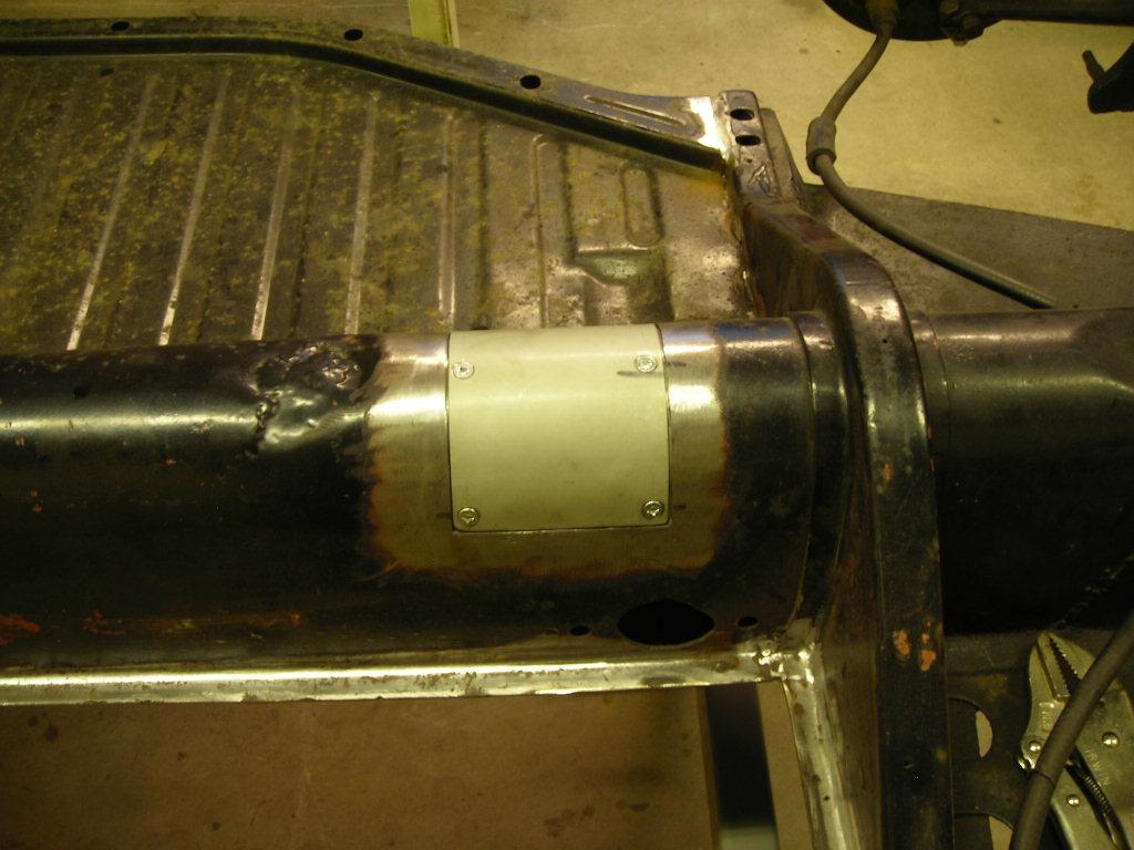

... saw this in a gallery and want to know if the access on the top of the tunnel, over the pedal mechanism was a stock - from the factory access in 1946?
And if so, When was it discontinued?

Not factory.

The access cover on the tunnel is not factory. You find those homemade openings often on bugs, they allow f. ex. to change the clutch wire without having to disassemble the pedal cluster.
Evidently there were RHD bugs in 1946 already. Attached fotos of such a car, believed to be built in February 1946, that a friend of mine photographed some years ago in an Australian museum.

The picture that you have is our '46. The front of the tunnel was badly butchered when the restoration began. Some previous owner had simply hacked a hole!
The restorer asked if I wanted it restored to factory or have a reinforced surround welded below a cleaned up hole and a flush fitted almost hidden access plate fitted, it is retained by countersunk set screws. My choice was the latter having experience of changing a clutch cable on these cars in the past.
The result is access available to the cable area and with the tunnel as strong as the original.

Would you mind taking the plate off and posting some detailed pics of the reinforcements done?

Here you go...
Don't take any notice of the left floor plate, its presence is a long story. Both floors were eventually replaced like this with new floors supplied by Kdf Osnice ( https://en.kdf.cz/inpage/catalogue-kdf-82/ ) suitably created by Ivo for a saloon.
