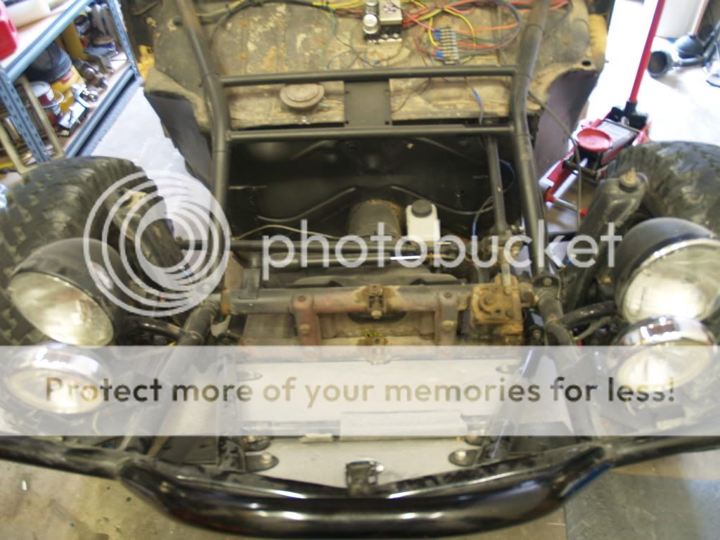

I know it's possible to widen a bj beam by welding in tubes to make it longer, but am I better off buying a widened lp beam off of chirco or something? I haven't seen anybody selling widen bj beams, is that because it's just better to go lp if you're widening anyway? Also my beam is tied into the cage, but I also still have the frame head. Where does the frame head need to be notched to fit the lp beam?
(yes it's dirty, sorry it's an old pic Laughing )

Ive never heard of any one notching the frame head to fit a different type beam in their car. I guess it could be done, but i dont think its the best idea. Though you do have it tied into your cage and that will make it a bit stronger.
On a different though, if you notch it, you will have to notch for the lower beam, other wise you have to replace the cage that ties into the beam. So you go ahead and notch the frame head for the lower beam, but this just raised the beam up, which lowers the car down.
So i think you might as well remove the cage tubes that tie into the beam, remove the frame head, weld in a LP beam head and get new tubing made. I know its a lot of work, but its better for the long run.
Or just settle with a widened BJ beam.

Using a LP beam requires notching for the top tube. The bottom stays the same.
But since you'll have to rehash the the cage anyway, might as well eliminate the frame head all together.
And might as well push it forward 8 inches.
And might as well go with +4 arms, and coil overs, and . . .

exactly the problem I run into everytime I try to think this through. so the lp beam wouldn't fit into the current cage setup I have?

No. It won't.
LP tubes are closer together.
If you only want wider, just widen what you've got.

There is a guy on the classifieds that sells a widened link beam that fits int he ball-joint framehead. I dont know how good they are but it is an option.

tyler theres a guy that sells metal bj to lp addapters in the classifieds here
i bought a set
over spring break im throwing a 6 over beam on my car with the addapters and tieing it into the cage the addapters also push the beam 1.75" forward Twisted Evil

The adapter would probably be the easiest way to do it...then pickup a couple LP beams and get makin

the adapter sounds like a good plan to me. I would also still need to modify the cage to take the LP beam though, right?

Ya because of the tube spacing but u would need to anyways haha!
With a 6 over u will have a real bad ass Baja! Cool
I figure why screw with my bj beam when I have a complete 6 over ready to go haha
