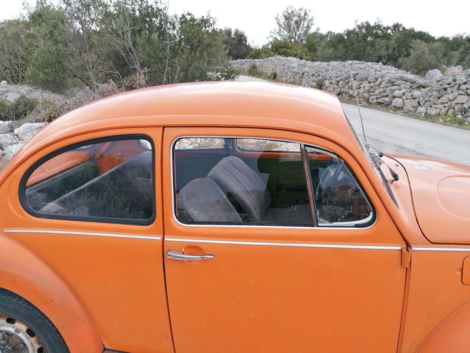

PostPosted: Sun Feb 27, 2022 10:14 am    Post subject: Re: Unable to bleed front breaks Reply with quote
Tim Donahoe wrote:
Vipraxay, I’m glad you were able to fix your problem. And your English is quite good, especially for a second language.
Show us a photo of your Beetle when you get the time.
Tim
Here you go, dont mind all the rust, paint spots and stupid decals Rolling Eyes , its still in the process of getting ready, this was a little bit of a test drive Very Happy
