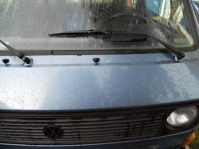

I'm getting tired of the front window leak that necessitated the removal of the constantly soaked carpeting and floor underlayment a few years ago, so I plan on replacing offending seal this Spring. I gather I'll also face some rust issues needing Por15 and some patching/painting as well. My van uses the factory "Cal-look" seal, so I'm hoping it installs with the old rope and pressure technique. My glass is getting a bit cloudy near the bottom, so I'd like to buy a replacement while I'm at it. Who makes a decent window for these beasts; PPG, Pilkington, etc.? If I were to have one of the major national chain glass suppliers install the window into my personally prepped and painted frame, who would you recommend?

Same problem--wet floorboards after hard rain. Sealed every penetration, better but still wet. Replaced the windshield with new seal from VC. (fixed rust and some pinholes while it was out) The lame installers blew off my request to use a sealant. Improved, but still leaks after a heavy rain. Might try the D-I-Y fix mentioned before going to a good glass shop, have them pull and re-install the windshield using some type of non-hardening sealant. Any recommendations on what sealant to use?

I've done a lot of body and glass work in my day. The sill needs to be completely repaired and symetrical first. Water will pass through a pinhole.
Stay away from silicone in this application - it will eventually age, harden and pull away.
I like using urethane: http://www.repaintsupply.com/pd_08609.cfm
It also comes recommended from doka owner and glassman Stacey in the Bay area.

WestyBob - Do you recommend sealing all the way around the perimeter of the windshield with the urethane? One of the shops I spoke to said they usually only seal the top and a bit down the sides from the top.

Yes because usually by the time a seal needs replacement there are imperfections in the outer sill which can eventually allow water in. That is, it's no longer 'perfect' as it came from the factory.
Some people with a new seal can initially acheive a good fit without assistance of sealant but that's rare, and often the water intrusion is not immediately realized until years later when they discover the sill lip has quietly and unnoticably rotted away (and water then starts pouring into the cab again).
For that reason I recommend this urethane or something similar be applied completely around the seal prior to install, and then applied completely around under the outer seal lip after the install. The idea is to do everything possible to stop all water from penetrating under the seal for as long as possible.
This all holds true particularly for super old rigs like our vanagons.
The sealant doesn't cost much so why not ? Water will get into any access no matter how small, will settle initially unnoticed perhaps for years, and do its work, and rust never sleeps.

This is what was found under my Transporter single cab's original windshield gasket. Crying or Very sad
Right side
Middle
Left side
Before I removed the glass and gasket, only the middle showed any sign of hidden rust but I would find water on the floor boards if I parked nose slightly up. And since at always rains in Seattle Wink , that was quite often.
My body shop is going to repair this correctly; cut out and weld in new metal, seal, prime and repaint.
I've R&R'd a few Vanagon windshields in 20+ years since catching the Vanagon disease but I've never used any sealant around the windshield gaskets. No leaks that I know of but perhaps I've been lucky?
I'm no WestyBob but I'd like to think I've gotten a little smarter over time so after spending the big $$$ to have all the body work done on my single cab, what's a few more for the sealant and no worries? Cool
Middle
I suspect I'm facing the very same rust gremlins lurking in dark corners. I previously filled in the .25 gap in the seal, but it didn't staunch the flow of water.

When you apply the urethane, or silicone in 10c's case, and you are peeling back the outside portion of the windshield seal, are you putting it under the glass or body side...or both?

On the body side for sure making sure you don't over-stretch the new seal in the process. Make sure the new seal is still tight to the body when done and clean off the excess urethane that comes out immediately.
You can use silicone or urethane in the groove that the glass sits in or neither. Some like to do that to hold the glass in the seal for easier install. But this is not where water typically gets into vehicle - once the windshield is installed the compression is very high where the seal and glass meet so it's all optional here.
The most common area the water gets under the seal next to the body is the top two corners followed secondly by the sides. It then travels down to the two bottom corners and also the bottom middle area.
Where the glass fits into the inner seal groove there won't be any water getting to the sill unless the seal is punctured.
