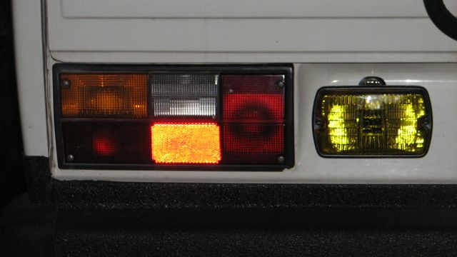

Pretty sure that 1621 has got a fog lamp mounted on the rear of his Westy!
Looks very nice, too!

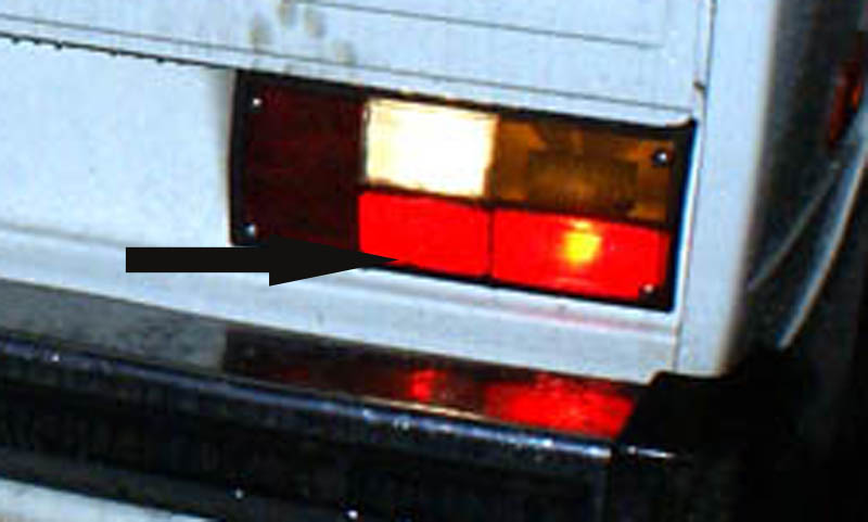

I did the mod like in the post above. Added extra 10w running lights. I would like to think the mod is a good one. I have seen a lot of vanagons running around with one side out and a whimppy 5w on one side.

The 1621 pic. above shows a yellow fog light for backing up or rear lighting for camping only really.
I did the mod posted above long ago to add more rear brake lights and the improvement is minimal as shown here- even though this example is tied into the running lights you can see the difference.

The light in the picture is simply a back-up light, not intended for use as a rear fog. It just happens to be originally intended as a fog light. I've since replaced the yellow lens with a clear and it serves it's purpose well.
I also did the taillight mod to the unused section, but like Syncrodoka pointed out, the lack of a reflector and the design of the lens limits the amount of visible light. While nice, certainly not an effective rear fog light.
Stephan (The 1.8T originator) has an external rear fog on his Syncro. I would think it would get bashed up if you're really into offroading, but might give you some ideas.
