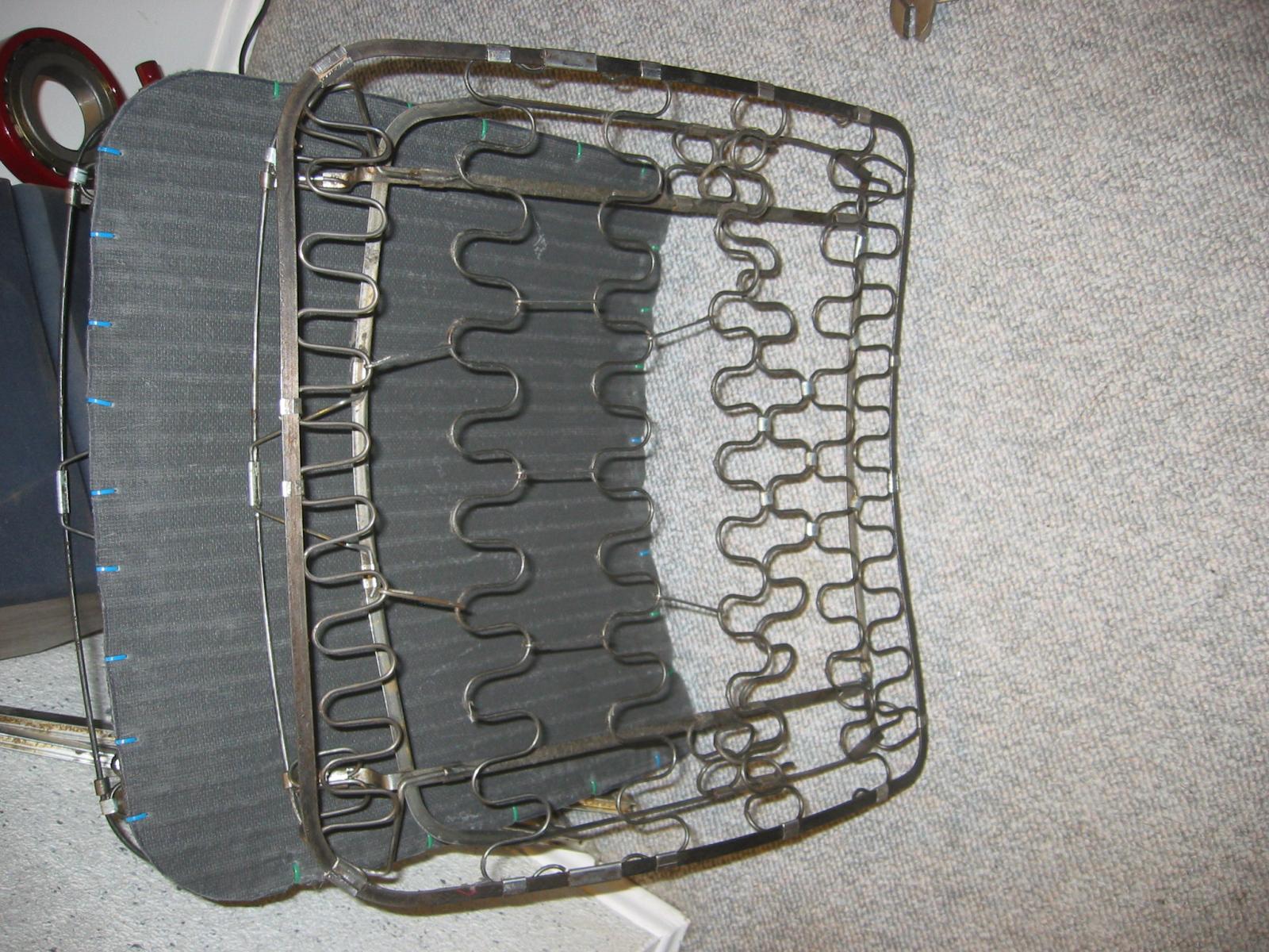

Burlap or thin industrial carpet over the springs, then 3/8" Jute, then 1" high density foam, doesn't get any better. For upholstery, Sewfine, top of the line products.
Hair? The original VW pad was Coir, coconut fiber. If the pads WW are now selling are indeed hair I would question the longevity of them.

I have used both - depends what you like. As mentioned horsehair is firmer - But there is nothing wrong with foam if done right and properly covering the springs is VERY important.

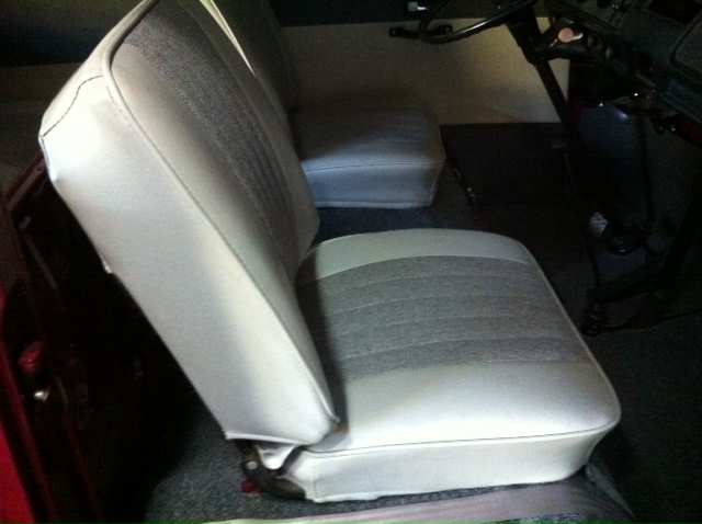

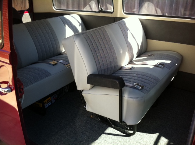

I've used both as well. I had a local shop do my middle and rear seat custom (similar to what Busman describes above) and they came out really
nice. For the two front seats I used my custom covers with WW seat pads and they were good at first but I had my shop then cover them in burlap and it made them much better.
