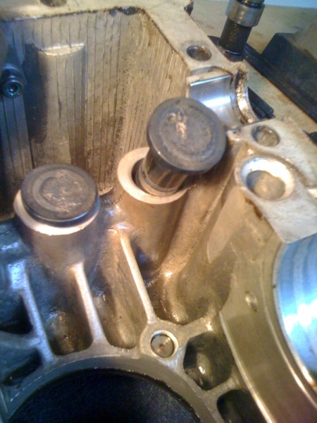

But here is where I think the problem is
Using an enge 110 cam and measured the lift with dial mic and here is what I found. All intake valves between 380 and 390. Exhaust on 1& 3 also between 380 and 390. However, exhaust on 2 & 4 both about 340 big difference. So it seems I have a bad lobe.
It seems there is nothing for it at this point except to tear the engine apart again and get a new cam.
If this assessment seems wrong please let me know, it will be about a week before I can get to tear the engine down again.
