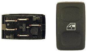

Has anyone installed the budget window switches from our friendly usual suspects, VanCafe, BusDepot etc?
Do they actually fit. I understand that the wires have to be soldered on or connected through a "cube".
If anyone did, photos and explanation would be most welcome.
Thanks

They are not budget window switch. They are the same switch without the wire tail. Just unsolder the wire from the old switch and re-solder to the new one.

Soldering may be better, but I just used female disconnects and they work fine on the one I ordered from van-cafe.com
That's not correct. They budget ones we sell for $12.95 and Van-Cafe sells for $14.95 (same switch) are aftermarket rather than genuine VW. AFAIK they have only been on the market for a couple of years under this brand, so all I can tell you for sure is that they seem to last at least that long. As for whether they'll last 10-20 years like the originals ... well, ask me again in 10-20 years. Smile
We offer both that and the genuine VW switch. The genuine ones have been obsoleted by VW of America but we located some Passenger Side ones in Germany and have them for $59. That's about 40% off their last U.S. price (which was about $100), but still a lot more than the aftermarket one. Driver side ones remain about $100 for now.

I started this post as no one felt it necessary to answer my Passat window switch post or knew the answer.
To make a long story short, I noticed that the "replacement" (not budget my Lord Laughing ) looked curiously similar to the Passat switches.
So I got some Passat switches, ninety nine cents a piece and will try to mount them.
Success or failure I will post photos.

Being a cheapskate, I didn't realize a $12 switch is a budget switch. Sorry about that. The lowest price I have found is :
http://www.autohausaz.com/search/product.aspx?sid=xabyd1551zwd4p55uwykv0ee&partnumber=191959855
$11.02 a piece. Seems to be the same brand as VC and BD from the picture.

This is the budget switch off the BD website

all that is is a MKII golf/jetta or B3 passat window switch.
you'll definitely have more luck finding a used one in a B3 then anything else.
that is unless of course you buy them from BD.

Well after closely examining the various Golf/Passat/Jetta window switches, I thought I would follow the easy way instead and go ... Subaru Laughing
Passenger side:
Driver side:
Color match my (whisper) Blue Star Embarassed
$2.50 each, sure beats anything black requiring soldering. connecting cubes etc at each $18+ or $120+ , plus shipping.
