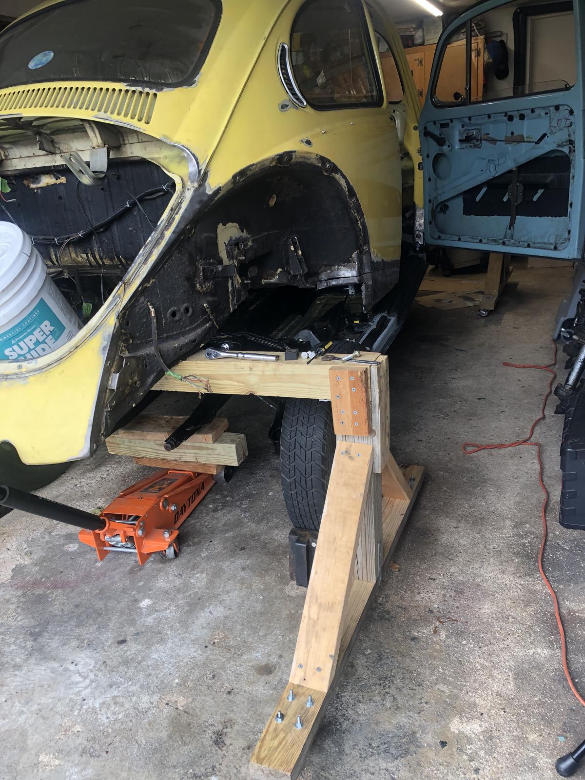

I don't know much about the gantry crane but I had success building 2 typical solid horses with locking wheels on them and lifted the chassis to the body using a jack and jack stands.
I can do this myself without relying on any help or another piece of equipment in a tight space. The bug me videos gave me the idea and show you how to separate the chassis from body using this method. It does take time to getting front bolts and rear shock body bolts lined up but after a bunch of times doing this method I got faster at it. You'll have to go back and forth with the jack and stacked wood on the jack (unless you have 2 jacks) and will still have to get underneath to bolt up. You also will have to rest the front on the bumper brackets (which I wasn't too crazy about at first) because you won't be able to lift the full chassis with the front horse in the wheel arch. Those areas will have to be solid and not rotted or weak. I don't have any transmission on either. All held up this way fine. Once bolted up it's easy enough to let the car off of the horses and down on its wheels and back up on the horses all by yourself. This system worked great as I just completed heater channels as well as front firewall repairs and rear cross members so I had to test fit many times. I thought it worked great. I also have a super beetle so not sure if this will work for standard. These are the best pictures I have to explain this. If I can find more I'll post.

I agree with you on "outside the box", and would do so as a general approach. That said, I've put off dual bursectomy (shoulder bursa removal) surgeries to repair 35 years of rugby addiction (I'm in my 60s).
Besides saving me a painful recovery, the hoist will play for itself as I am replacing the FJ40 body with an aluminum tub this summer.
The FJ40's body is a bit heavier than the Bug's and the removing this rig's top will certainly make my orthopedic surgeon richer.
