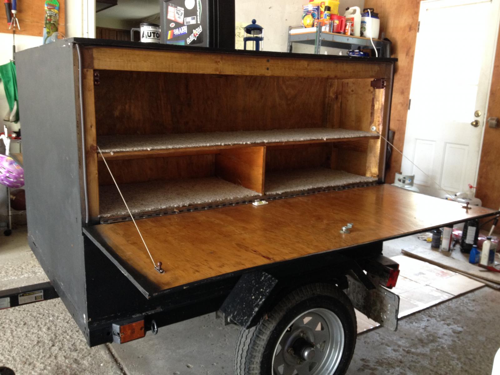

]Not sure if anyone here is interested but I’m building a small trailer for my Westy to store misc. camping equipment on one side and have a mini kitchen on the other. I started the design phase of the project for fun and since I’m a Certified SolidWorks Professional (CSWP) I did the layouts for the design in SolidWorks. I’m going to pickup the wood next week and start the build

How high off of the ground will the right side hatch be when opened? You may want to make sure that it's high enough that you don't have to stand there bent over the whole time you are prepping lunch/dinner/etc. as it could lead to one heck of a backache!
Other than that, it looks great! Very functional, nice design. I will be interested to see your progress.

Well, my wife says that's a good height for the counter, so that works for me! LOL. I'm sticking with wood for now as the total cost for me is under $200 for everything.
I'll make the box as smooth as possible before the paint. After paint I was thinking of a nice thick clear coat. IDK. Still formulating the plan for that...

He's got a weekender, but I do see your point.
I like the flip down shelf a lot, even with a full camper. It's nice to have the extra work space. Bike racks on top is a clever idea as well. You could go crazy and build something with all the gadgets and features of some of those adventuretrailers (very cool BTW), but it sounds like this is supposed to be a much more modest project.
A bigger question is how you intend to keep the elements out. Strong winds from the road mixed with a bit of rain tends to get everything wet unless water tight.
