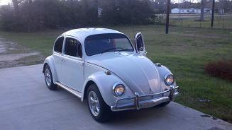

PostPosted: Thu Apr 07, 2011 10:02 pm    Post subject: Reply with quote
here is my 67 I picked up a few weeks ago
