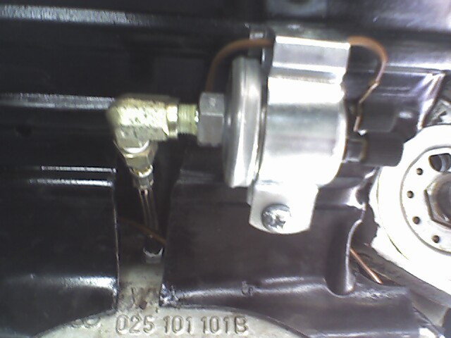

I installed mine as seen in the pictures below. As described in the van-cafe instructions, but I changed the position of the clamp so that I can easily unclamp the band around the sensor, and remove the tin from the engine without disturbing the sensor.
Installed since 2007 and still works great, no leaks.
