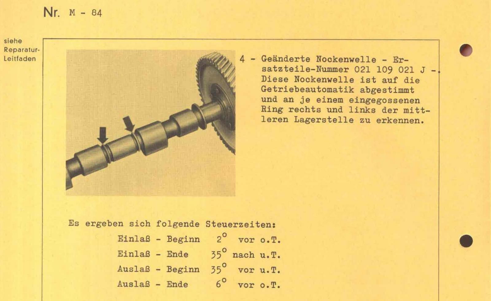

There´s factory note TM84 from september 1972 called "engines with automatic transmission"
And this one is from TM80, august 1972 for manual transmission cars

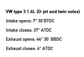

And here are the later cams...
I have Schleicher 296 (degrees measured in German way, I guess it´s about 276 in US degrees) and later 090 automatic. I wouldn´t recommend this, peak power is at 5300-5500 and it feels ridiculous to rev the bus that high. But I think 142 (if it´s indeed stock 411/412/914 cam) peaks at 4900-5000 so it´s better.
Thank you for posting these!
However.....this goes right back to what I was saying. The numbers in that technical data sheet do not match ANYTHING...I have seen anywhere........in the US/North American market.
It also does not match what was in the UK market as most of the numbers I have are from Haynes and I have verified the numbers from Haynes for 411/412 and 914....automatic and manual....which were the same camshaft in 411/412 and 914. They vary the valve body and not the camshaft from what I am aware on those vehicles.
I have not verified the numbers I have for type 3.
Also....note that your document states the same camshaft timing points for type 2 1.7L and type 4 1.7L....which have never been the same...ever.
And while its possible that those would be the timing numbers for a type 2 (bus) 1.7L.....those have never been the timing numbers used on any type 4 vehicle engine camshaft.... auto or manual.
At least....not anywhere near the North American market....which is why I ask...what market does that represent?
Here is what I have and I know these to be correct...for these North American Vehicles:
These are D-jet type 3 and are supposed to be the same for carbs...and are said to be the same for type 1 (but I have always doubted that last one)
These last two I have no idea for sure. It has been noted that the 2.0L 914 US version used the same cam as the 1.7L (and I have found that to be true).
The higher HP Euro 2.0L used a different cam. The Euro 412 1.8L with twin carbs is said to use the same cam and the significant HP and TQ increase supports that.
People "say" that the Web 142 is the same as this cam.

Ray, the TM80 is issued august 1972 so it's related to new engines built after that date. (But it also says this can be used as replacement cam for older 411/412). I just posted the two since there you can see automatics had slightly different cam, on buses on all markets. I don't know what exactly they used for d-jetronic.

and now that I actually read more of these endless notes (there´s hundreds of small changes to ignition timing etc) , in 1975 they started to use that lame automatic cam for everything Smile
But since this is a performance thread... if you use that Webcam 142 your transmission will shift to higher gear too soon and you´ll never be on highest power. You can modify the governor by removing material from the counter weights but in my case it wasn´t necessary, I just adjusted the metal bar between transmission and carb linkage (dual dellortos) and now full throttle shifts are after 5000 rpm (my bus is from 77 but transmission is from late model Vanagon so it might not work for you, maybe early 090s are different)

The earlier V series ...never made it here except in a very few 1971 411 and a few gray market cars. Pretty much everything that came here in 411 was largely the same as the first year of type 2 bus. And....I can't even find a CA series in most US books including my "without guesswork".
But....the cam listed for CD and CE......is not close enough to work with 411/412 and 914....with their injection system....without running like crap.
THAT...was the problem I and my mechanic kept running into around 1978 and 1979. Whenever cams were ordered for a 1.7L...the 411/412 was an obscure enough car that most parts jobber houses (outside the dealer)...simply assumed it was for a bus 1.7L and ordered that. It was usually a regrind....but the lobe timing was not right.
Interesting!
Ray
