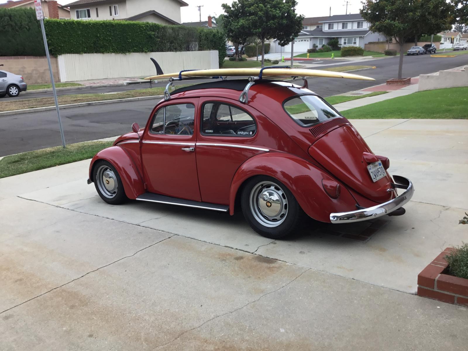

PostPosted: Tue Apr 07, 2020 7:38 am    Post subject: Re: drop spindles or stock ? Reply with quote
Stock a BJ beam has about ~4" of travel.
Wth an adjustable beam and stock spindles you lose some of that travel when you lower it.
When you do get it adjusted to where you like the look you will probably need to use short shocks too.
This combo makes for a bouncy ride and can often bottom out too.
If you just want a ~2-2.5" drop using the stock beam with dropped spindles will give you the best ride because you maintain the stock travel and shocks.
