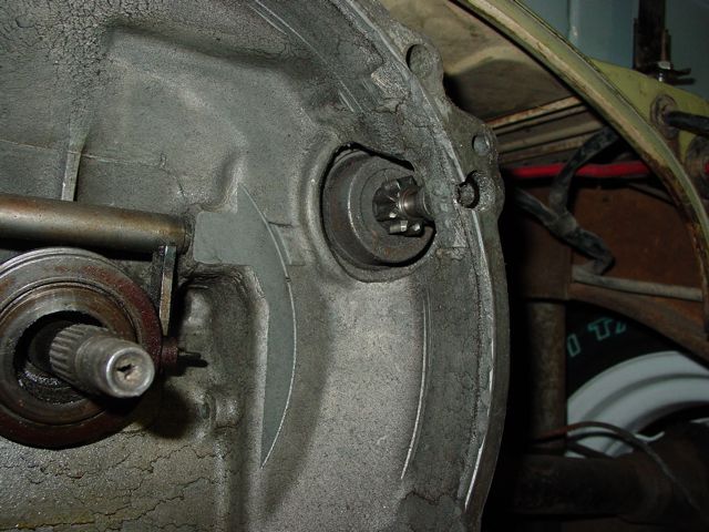

63beryl
Joined: November 24, 2006
Posts: 745
Location: SE Idaho
63beryl is offline
PostPosted: Fri Apr 22, 2011 1:02 am    Post subject: Reply with quote
The bushing is inside the hole you can see the starter shaft in. With the motor out you can remove/install the bushing in either direction.

PostPosted: Fri Apr 22, 2011 1:05 am    Post subject: Reply with quote
The transmission case is broken in this picture, so it allows you to see the little brass bushing inside the trans case.
