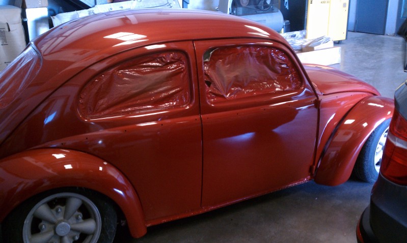

PostPosted: Wed May 25, 2011 8:46 pm    Post subject: Reply with quote
5 weeks in the body shop so far, patiently waiting. Went and saw it last week- bodywork done, ready for finish sanding and then paint!

PostPosted: Tue May 31, 2011 6:07 pm    Post subject: Reply with quote
Went to the body shop to visit her today. Still need color sanding...

PostPosted: Tue May 31, 2011 6:49 pm    Post subject: Reply with quote
Lookin' good!

PostPosted: Wed Jun 08, 2011 10:51 pm    Post subject: Reply with quote
What color is that? Its sexy Cool
It doesn't have a name, just a code. I was going for a copper-ish reddish orange sorta color and I found the perfect one!
