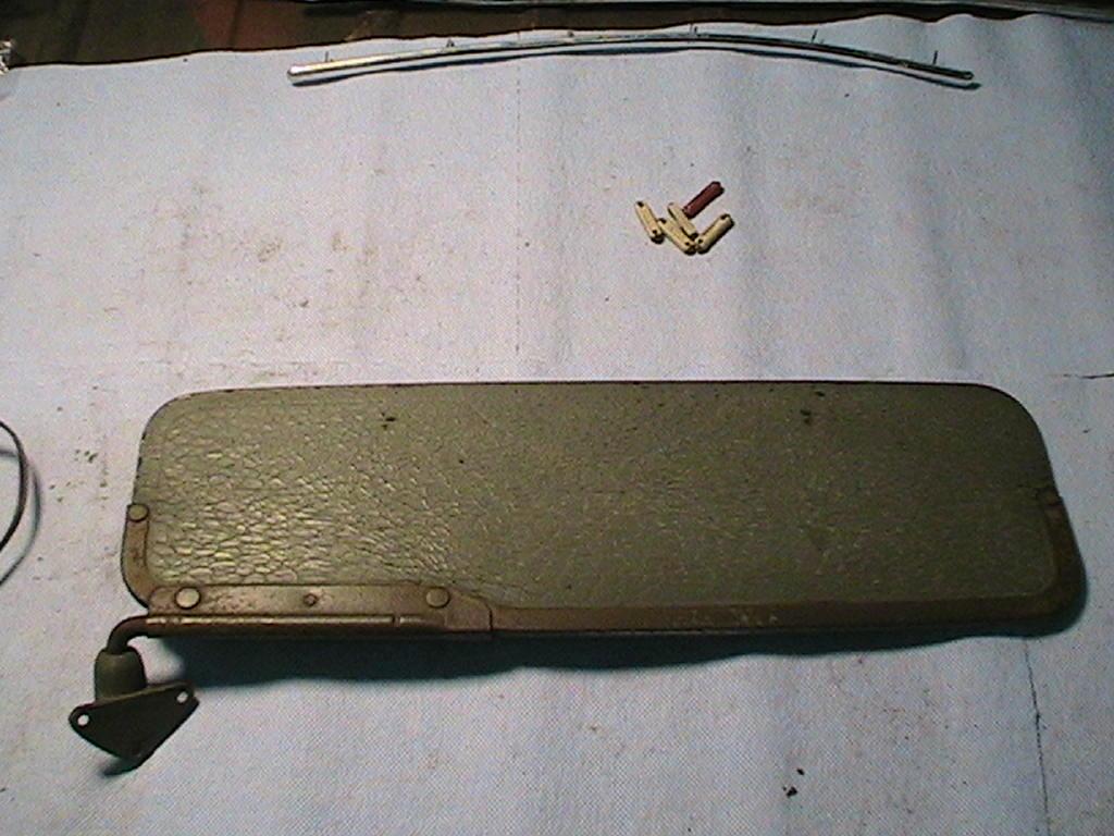

Hardboard visors a different color?
Here is a shot of the DS and PS sun visors from my 1-61 Kombi/camper.
They are clearly different colors. The lighter one does not appear to have been repainted. Were there different colors to match the various color schemes of early buses?

741 ice blue and 744 silver beige. Depends what color your bus was. You can check under technical to see what your bus came with.

The Ice Blue and Silver Beige are for the padded visors.
On the hardboard visors the grey ones are for Commercial buses
and the cream ones are for Mango passenger buses. The deLuxe
version would have chrome plated metal and a brown painted hardboard...

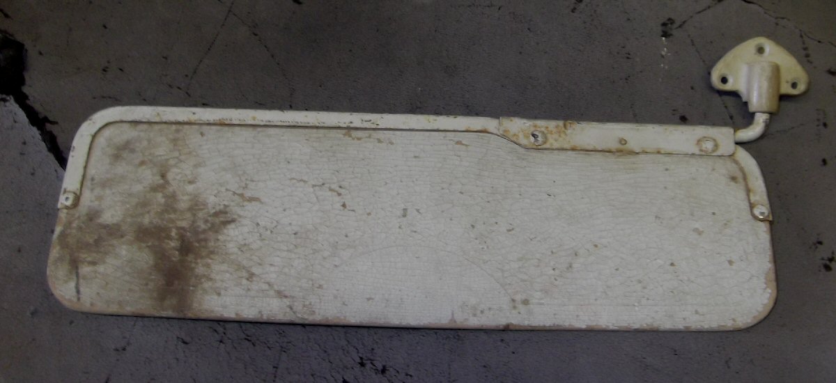

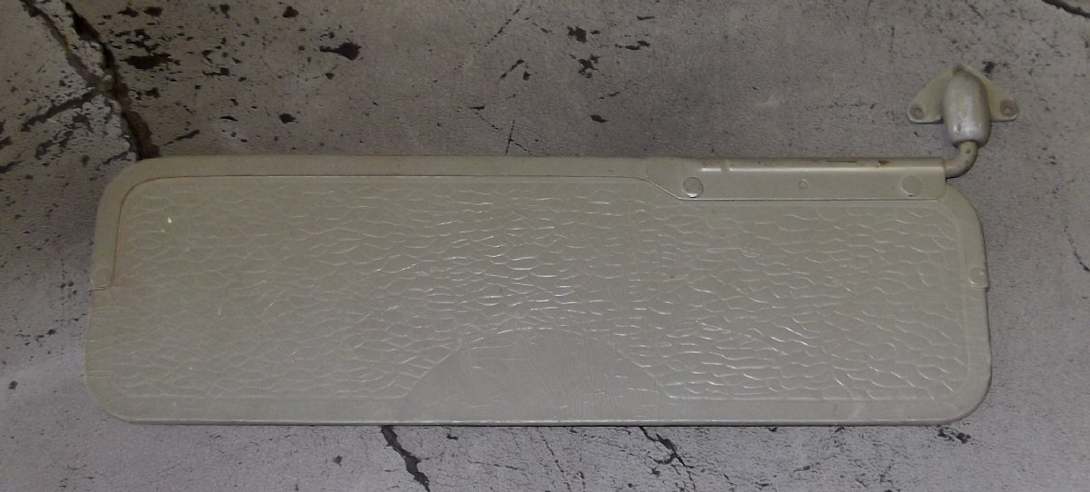

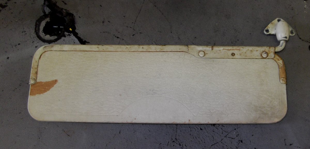

here are various sun visors from my collection. I am pretty confident on the applications through '63, but the later ones, I am not sure on.
'55-'61 commercial sun visor painted grey
'55-'58 standard sun visor painted grey
59-mid '61 standard sun visor painted beige
late '61 standard sun visor painted beige (plastic base)
55-'58 deluxe sun visor hardboard chrome
59-mid '61 deluxe sun visor diamond pattern
62-64? visor all models (available in various colors)

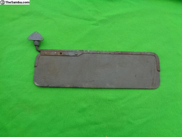

Just picked this commercial hard board visor up of here. I've been watching them since they came up all the time for $20-40! Honestly my Kombi's going into storage again for a few years.
Originally it had a perfect one, but the seller kept a few choice parts of my very OG bus. Visor - swapped out the OG great seat - tool roll & jack.
My Kombi has so much history and the previous single owner was so fastidious at keeping records I am sure it would have come with plenty of OG fixtures.My mind still wanders what else would have come with it if he's left well alone.
RANT OVER! Very Happy
Anyway the price of these part just keeps going up and up and I didnt want to blow $200 on one of these! Very Happy And I had to fill the holes!
NOW THAT IS RETAIL THERAPY! Very Happy
Going to see how well I can massage the rust / sticker gunk off.
THATS JUST THERAPY. Very Happy Very Happy Very Happy
Any way my question is screws - Grey or pop for these???
