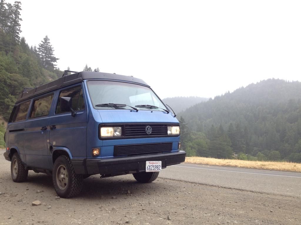

PostPosted: Sat Jan 03, 2015 5:53 pm    Post subject: Reply with quote
FWIW here is my van now:
[img]
[/img]
Dave
