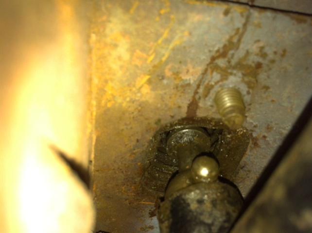

OK. 67 bus. Took it in for inspection here in Texas and inspector F's up sifter somehow. See picks below. I have to remove shifter hold down cover to reinstall shifter ball end and pin into shift rod cup but shift pin is real loose like OP states. I drive bus home fine about 2 miles but next day I take it for a spin and get no farther than 1 mile before shifter stuck in 3rd gear. I don't force anything and return home in 3rd. Inspection finds round end of pin in cup comes out again, see pics below. Do I need to remove shift rod and repair so that this pin does not move at all like OP was asking or is something else messed up. All other plastic bushings etc recently replaced.
Thanks in advance for any help as I cannot even get the bus out of garage at this point.

Take the shifter off from the top, clean it up and take some more pictures its hard to tell whats going on there

Hard to tell from the picture, but the pin doesn't look right. More importantly, it looks like your 67 has an earlier shorter shifter. Check the first photo in this thread. 66-67 shifters are longer from the pivot point down.

The ball should not be popping out of the socket.
show pics of the part the shift stick is bolted to, that has the loop around the shift rod under the bus.
don't worry about the the pin. You can just fit it back in the socket.
yes there is a small spring in there. Pin is supposed to be peened so it doesn't back out, but if the shifter is staying where it is supposed to it is not a problem.
worry about why the ball is popping out of the socket.
