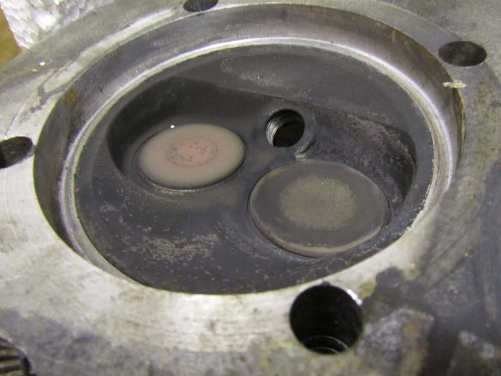

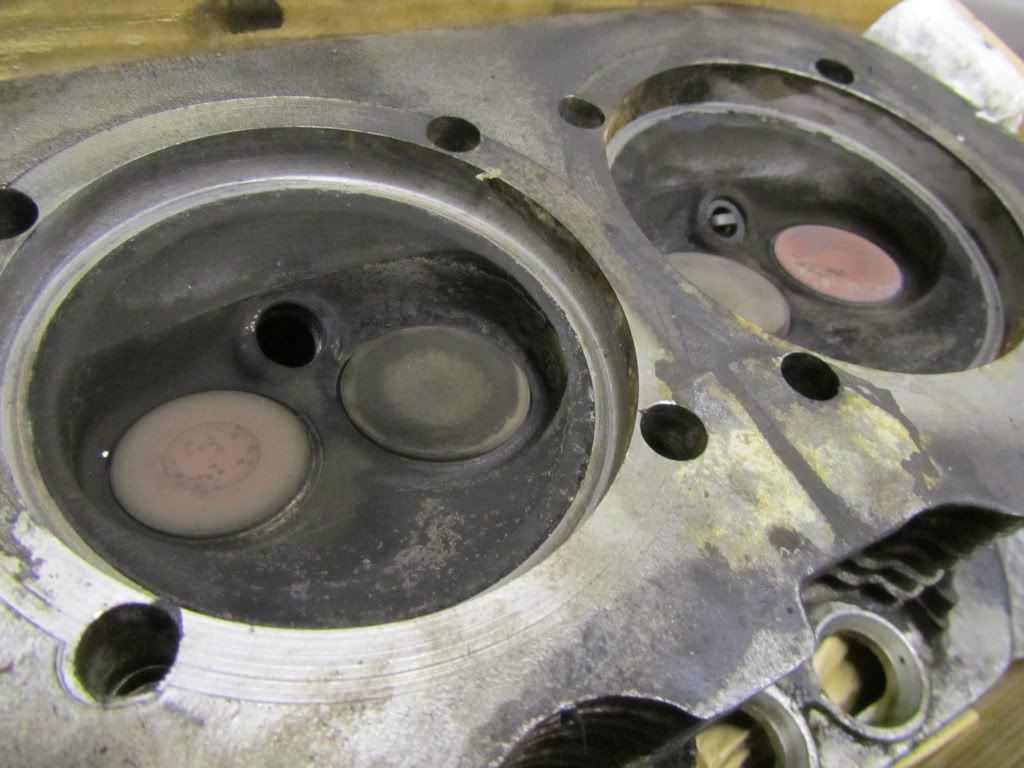

Heres a pic of them side by side, I'm certain that the new heads had less cc's just by looking but I should've checked. Such a retard. Embarassed

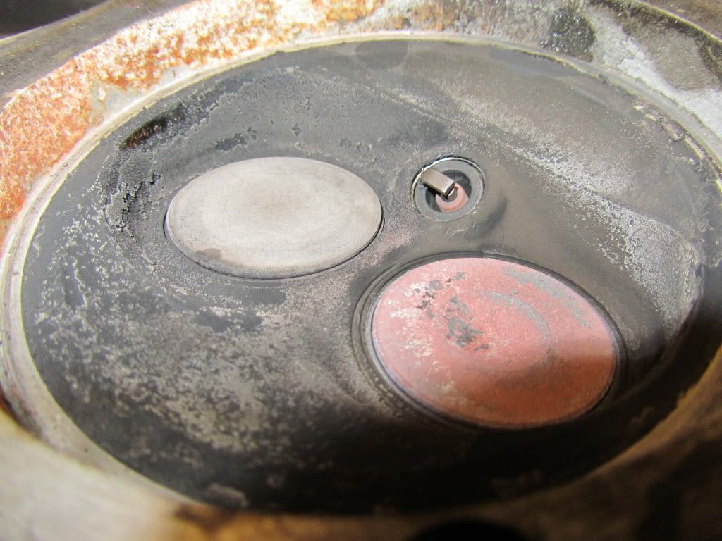

Can you get a cloes up picture of one chamber of the 040 head? is it heart shaped?
good thing is you can still cc the old heads to see what you HAD.

What version of the 044 heads did you buy? those chambers look nice and ported Cool look big though..

Just got some pics for you;
I'm not sure if you can see but they are dished and then scalloped around the valves whilst the new ones were only scalloped around the valves with no dish. I am sure they are of a bigger cc than the 044s.

Your old heads are deep fly cut AND semi hemi. Measure them and Im sure they will be mid 40s. The 044s usually have around 57cc chambers from the ones Ive seen. I would call to make sure what they are lately.
I think that difference in cc and chamber design made the difference.
