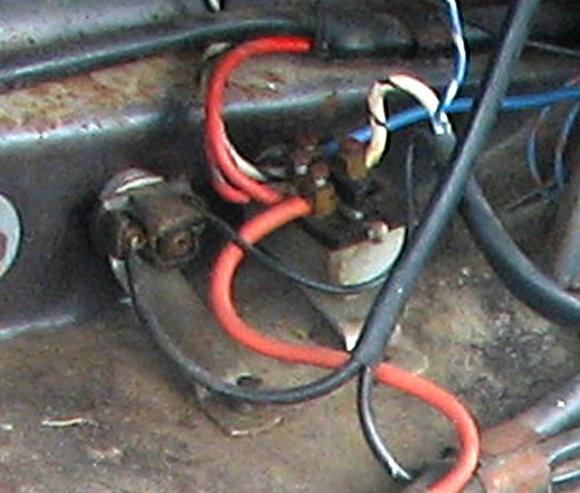

Headlight switch
Zwitter dome light
The problem with the dome light is that it needs to be released from both sides when removing it. Many just yank on one side with a screwdriver and crack or break the lens. (as in above)
