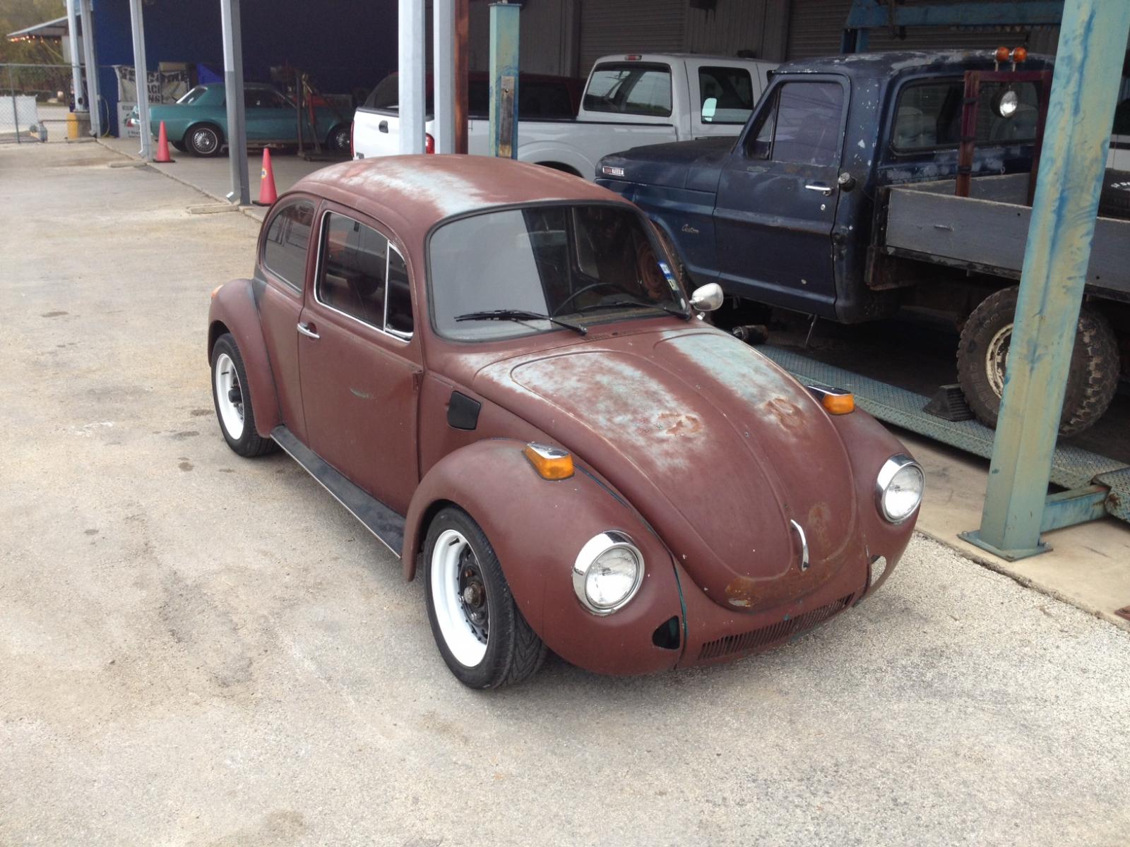

heres my 74. going to go with the rally theme, probably not going to enter it in any stage rallys, but more rallycross events.

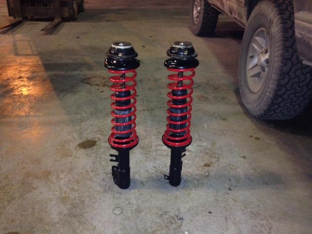

when I got her, the front end was toast, ball joints/tie rods/ ect... the previous owner install some adjust a struts and lowered it about 2.5"..
so I purchased some oem strut bodies, topline rally springs, kyb strut inserts, and complete front end rebuild kit.
just waiting on my wheels/ other parts to come back from powdercoating, then I can start assembling it!
heres a shot the first day I brought her home. and started teardown
