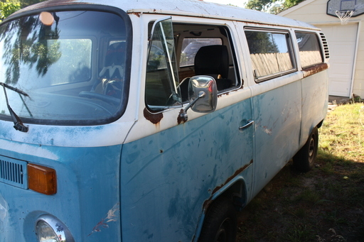

here is the low down on the bus
paid 900 bucks for it.
engine and trans are in unknown shape but both free spin.
the body has minimal rust except floor pans and battery tray need replacing.
dog legs and structural metal are in good shape.
all rubber seals still seal but will have to be replaced.
big dent in nose and passenger door.

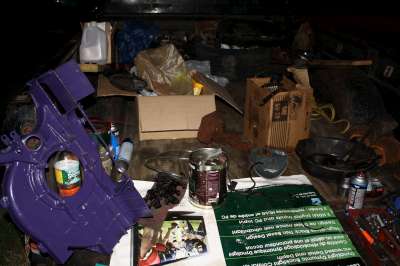

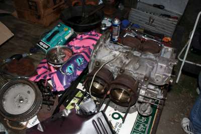

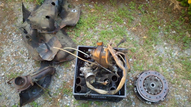

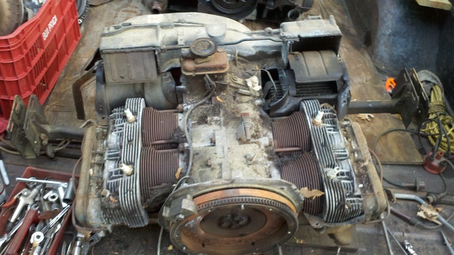

i went on Wednesday to my friend and Club prez Rufus to help with the bus engine tear down. here are the pics of it
the start
after the FI system is removed
FI system in a milk crate
where we stopped at long block with oil drained out.
the oil didn't have any debris in it, the engine has good compression, and the only thing we found was that there was fuel in the oil. about a quart of it. so far everything it looking good. we will see once we take off the heads and finish the tear down. Wish us luck.

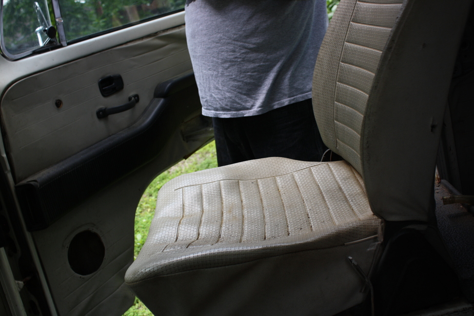

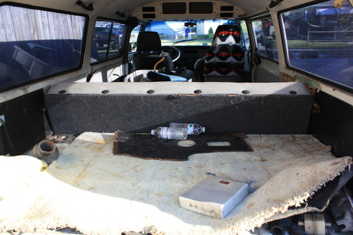

PostPosted: Fri Jun 10, 2011 3:48 pm    Post subject: Reply with quote

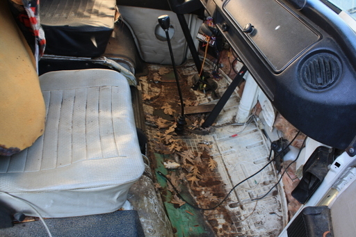

here are more BBE pictures
drivers floor board
steering wheel and dash Smile
passenger seat and my gut Laughing
head liner and back view Smile
the BBE Cool
passenger side
passenger side rot and shit patches Shocked
the cargo Smile
rear seat and spare parts (including full FI system and old engine) Smile
the cargo patches

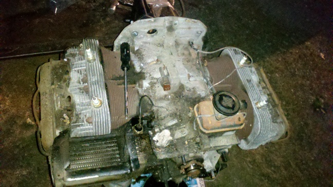

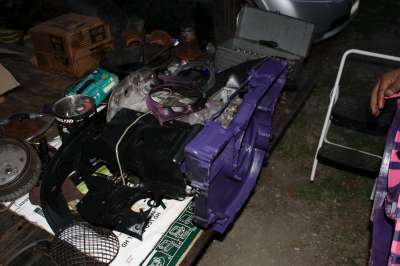

more engine tear down pictures
everything had really good compression everything looks good so far.
i got the heads off and cleaned up, will have pics later and currently my wife is cleaning up and repainting the tin. Very Happy

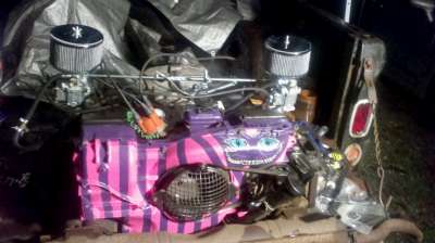

here is what has been happening.
i have ordered a dual carb setup. (i know FI is better / correct Rolling Eyes )
got in tail lights, front signal lenses, battery tray, cv boots, brake hoses, bentley manual, shifter coupling, and a tons of parts.
engine has new bearings, rings and mostly reassembled.
engine tin is painted and test fitted
CV axles are reworked (boots / grease)
still need a fuel pump and regulator any ideas? need 3.5 psi.
heads need broken studs removed/replaced, cleaned, and reassembled.
fan housing my wife painted up
should have heads on and fuel tank out by sunday.

freednighthawk
Hah! Is that the Cheshire cat? Love it.
Very Happy it sure is she liked the colors of the original Disney movie and the style of the new Alice movie. i was skepitcal at first but after she finished painting it i find i was mistaken. she does really good work. i'm trying to butter her up to do some work on my engine tin for the 65 sunroof.

PostPosted: Mon Jan 23, 2012 7:21 pm    Post subject: Reply with quote
vid of the engine running since rebuild
