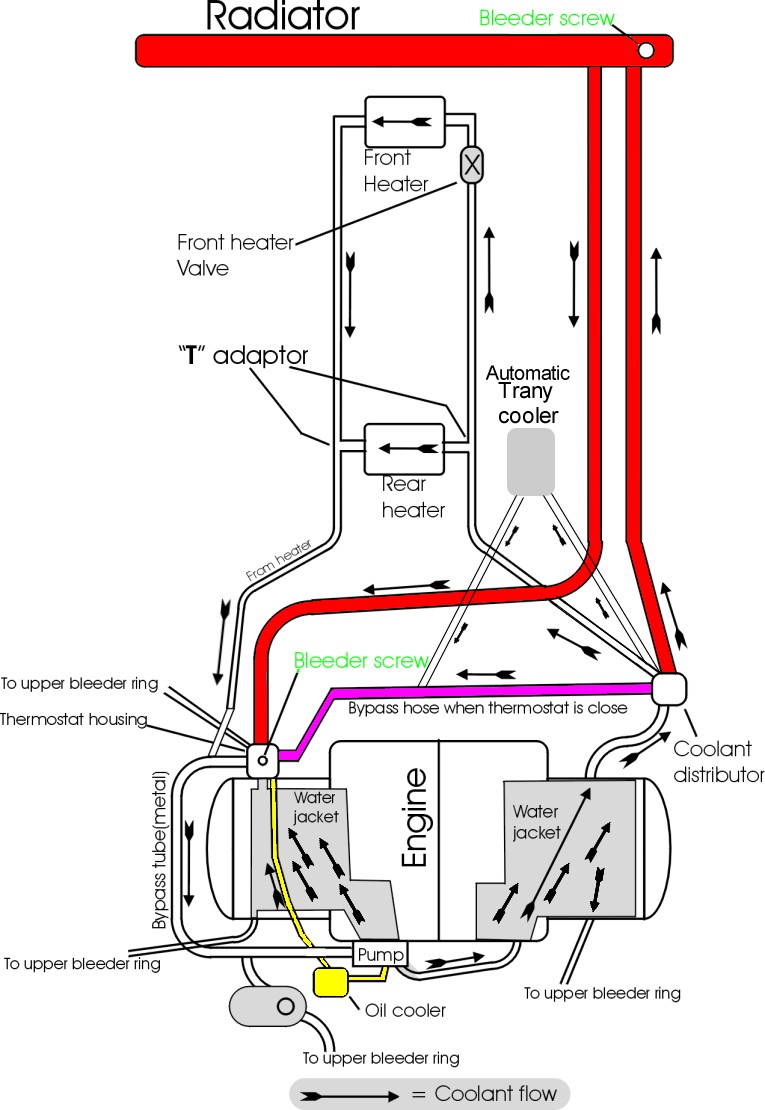

PostPosted: Mon Dec 01, 2008 9:53 am    Post subject: Reply with quote
I've found these two images helpful when trying to get a handle of the cooling system. I believe they are from Ben's website.
