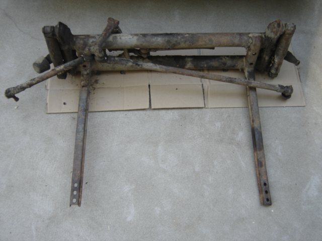

Hmm. BD boxes do rotate opposite direction from later split. Using a later box would produce the condition you describe. A picture of your pitman arm,drag link and swing lever might shed some light.

Found these in the gallery. Might be of help.

My sincere apologies for hijacking this thread, but as a BD newbie, I have to ask...what are those 'reinforcing bars' actually called, what is their purpose and were they standard equipment on all barndoors? Thanks.
