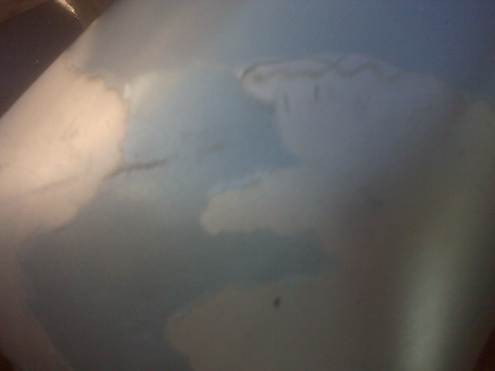

First, one of the mirrors is "burnt" I guess you would say. I saw the replacements on Van-Cafe for like $70, and that just seems ridiculous for a single mirror, as I paid $50 for both!
Power Mirror Glass Left Side Flat #251.857.521
http://www.van-cafe.com/home/van/page_1346_614/power_mirror_glass_left_side_flat.html
I realize that is an expensive VW thing and not Van-Cafe, but there has got to be an easier and less expensive replacement method. Can a local glass shop do a flat and a convex mirror? It seems I could take that and get it copied pretty easily?
Van-Cafe offers another "stick-on" product, but I am considering wiring up the defrost function, and I think I would lose that ability if I stuck the new mirror on top of the old. This is a possibility however if I cannot find another method. The stick on is like $37, and simple, but I need to pop the mirrors out anyway to do a proper re-paint.
Next, how do I pop that out and swap? I could learn myself, but this would likely be at the expense of some hard to find plastic part. Anyone have experience with this?
Finally, there is kind of a clear coat on the outside of these things. As you can see in this pic, mine is worn.
I would like to change the color and bring them back to new. What is the best method to repaint and how do I apply a new layer of the clear coat material (what is it?)?

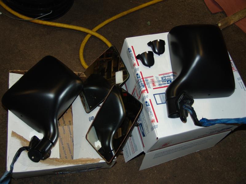

Good timing for your questions as I just finished a set, along with factory cruise control, going to Australia to upgrade a Syncro Doka.
I cleaned, sanded, primed and painted them with the factory trim black from Wurth.
I supply all factory connectors and wires.
Spending the time to carefully remove the wire ends from the plastic connectors takes terminal tools and patience.
Yes, the non power mirror doors will be missing the third attachment point and will need a threaded insert.
The mirror assembly has a triangular plastic gasket that is usually hard to come by new.
Classic VW in Germany has started to reproduce them, but I have not seen them reach the US vendors yet.
The heated mirror glass is NLA and due to this my cost for this kit is out of reach for most, but I do sell them on a regular basis.
I have three kits available:
Trim black complete
Non metallic body color matched complete
Metallic body color matched complete
I do not sell non working parts nor do I sell individual parts any longer.

Thanks for the post and pics. Those look very nice. Let me just ask a couple of detailed questions...
Is there a trick to popping out the glass?
The Wurth product, why did you select that particular product?
It sound like the heating element and the mirror are one piece? If so, can two different pieces be merged to make this work?
I have no idea how to approach this threaded insert...ideas?
Thanks for sharing your talents!
On a mission, the destination is just an excuse.
Syncro Solstice 2022...see you there!
1986.5 Wolfsburg Syncro Westfalia Poptop Weekender Transporter
insyncro
Banned
Joined: March 07, 2002
Posts: 15086
Location: New York
insyncro is offline
PostPosted: Tue Jun 14, 2011 10:23 am    Post subject: Reply with quote
Classicvibe wrote:
Insyncro...
The mirror glass and heating element are one piece.
They do not come apart.
You can either use a broken mirror glass assembly and secure a new mirror to it, just as available from VC and loose the heating element of the glass or try to find a good used replacement glass.
A threaded insert is a large rivet with internal threads that you attach a bolt too.
I use them for panel fasteners and many other upgrades where you need to be able to remove the part easily.
I have two tools to set the threaded inserts, one Snap On the other is a Wurth...both are hundereds of dollars.
I don't really know how to attach the mirror without them.
I use Wurth products throughout my restorations and upgrades as I feel they are the highest quality available and many were used at the factory when the vehicle was being produced, so everything matches beautifully.
Yes, they are extremely expensive and you must be a dealer to get them.
Goodspeed in the classifieds section sells a few of the spray can products and offers to direct order any product they don't stock.
Hope this helps.

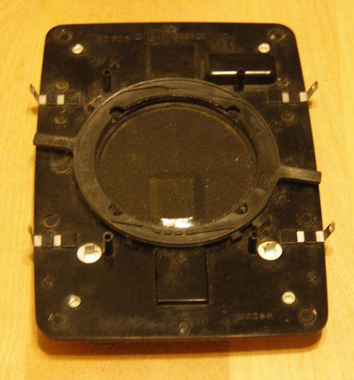

If you look closely behind the mirror by tilting it all one direction, there is a tab on a ring that you need to slide to unlock the mirror and heater assembly from the housing. It's like an 1/8 turn lock ring that needs to rotate to unlock the mirror. I'm sure someone has a picture in here somewhere. Be careful.
http://www.thesamba.com/vw/forum/viewtopic.php?t=414891&highlight=mirror+remove

It has been awhile since I replaced my standard mirrors with the power mirrors, but from what I recall, If you look between the gaps on both sides of the mirrors you should see a tab in the middle of each side.
These tabs are connected to a disc that rotates to lock the mirror in
Using something like a popsicle stick, push one tab up and the other down (or vise versa), this should release the mirror.
After a light sanding, I used Black Krylon Fusion Plastic spray paint.
I mounted mine using the two existing mirror holes and have not have had any problems. http://www.gowesty.com/library_article.php?id=811
the mirror glass and heating element are not one piece and the aluminum is the split in two halves and a resistor (10ohms) heating element is between the aluminum halves. the aluminum is insulated and is adhered to the glass with a plastic putty. i have not been able to find the square flat resistor heating element.
Exactly....it is replaced with one piece, the entire mirror glass, if you can find them.

I have a question about those gaskets. When you swap from the old manual mirrors to the new power mirrors, where do you get the gaskets?
Are the gaskets rubber or a thin hard hard plastic? (I may have one if the latter).
Also, I understand you have to drill a new mounting hole -- do you just put a nut there or do you need any special reinforcement to protect the door sheet metal from being pulled and warped or ripped out?
Randy,
That hard plastic triangle like piece is the gasket. I've been running two of my Vanagons without the 3rd screw for about ten years now without any issues. However, you can put a 'nutsert' in there as the best alternative to stock IMHO. Others have used sheetmetal screws or a freewheeling nut on the inside. I think the latter solution is also a good anti-theft measure. They'd have to get in to the van and roll the window down to take the mirrors.
BenT
That should be interesting. IIRC, the RHD mirrors are aimed slightly different than our LHD mirrors.

I concur with Ben that RHD cars have a different ""drivers side mirror than a LHD .
As far as the replacement mirrors which are designed to be glued on over the top of th existing mirrors, I supply these to various Vendors. I actually took a stock mirror plate with one of my mirror double stuck on and froze it over night ,I then hooked it to 12 Volts and it defrosted just as well as a stock unit .
I have tried to separate the stock mirror from the backing and do not advise doing it ,as it will destroy the backing plate.
I do not sell the mirrors directly . I can let you know who may have my units to buy ,but you would have to buy them form there.
Stacy

It's my understanding the heating element is strong enough to heat the underlying defective mirror plus the new stick-on mirror as well.
