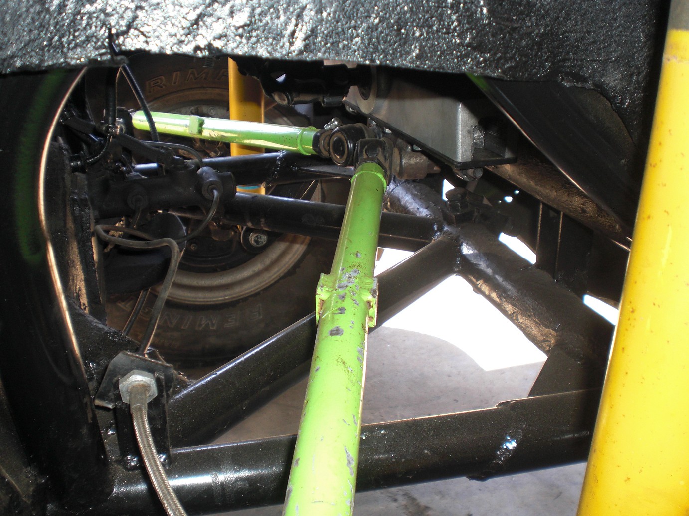

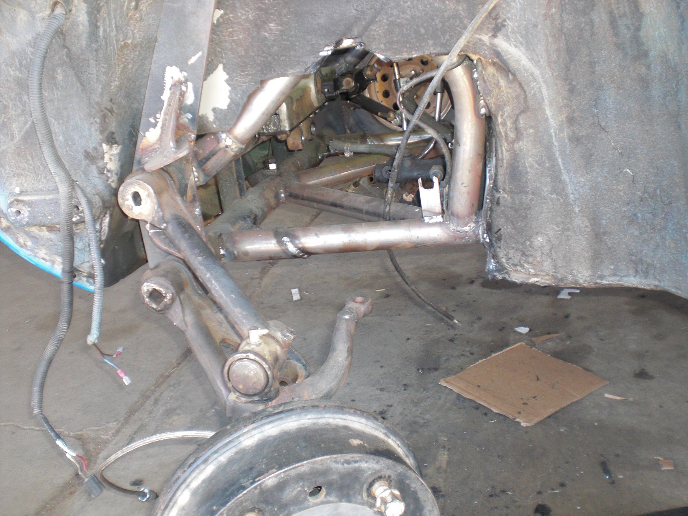

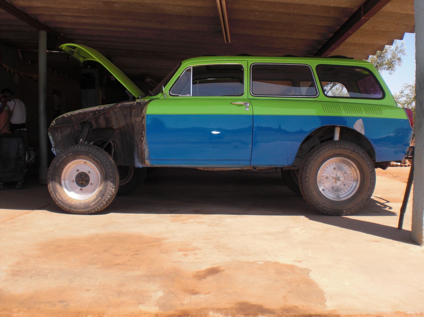

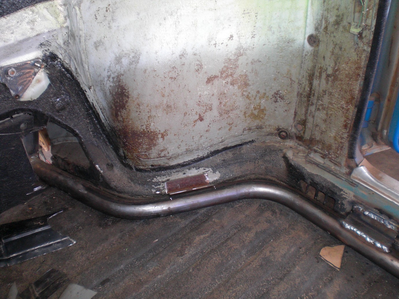

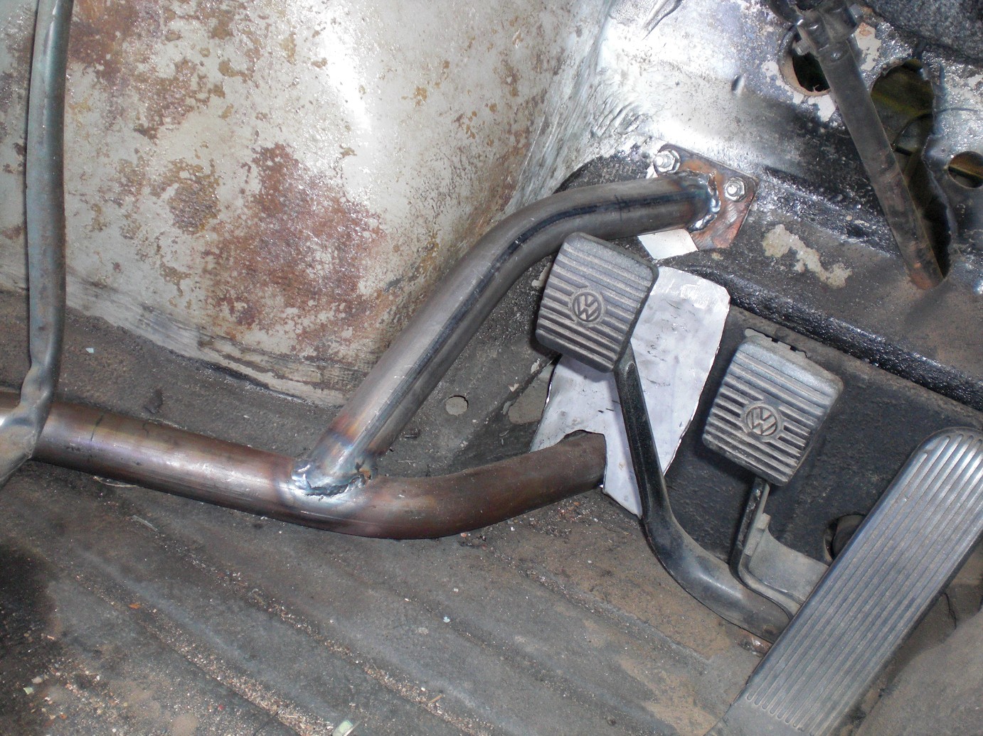

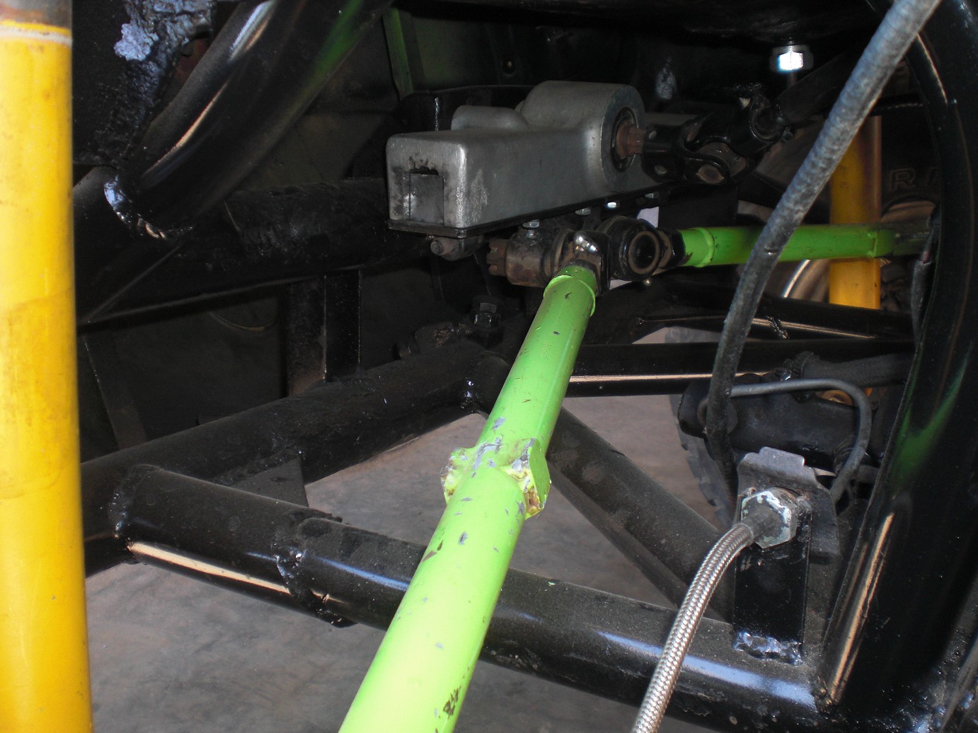

PostPosted: Thu Jun 23, 2011 11:52 am    Post subject: Reply with quote
Here are some photos of the subframe work (including 'finished') FOX shocks will be next...
