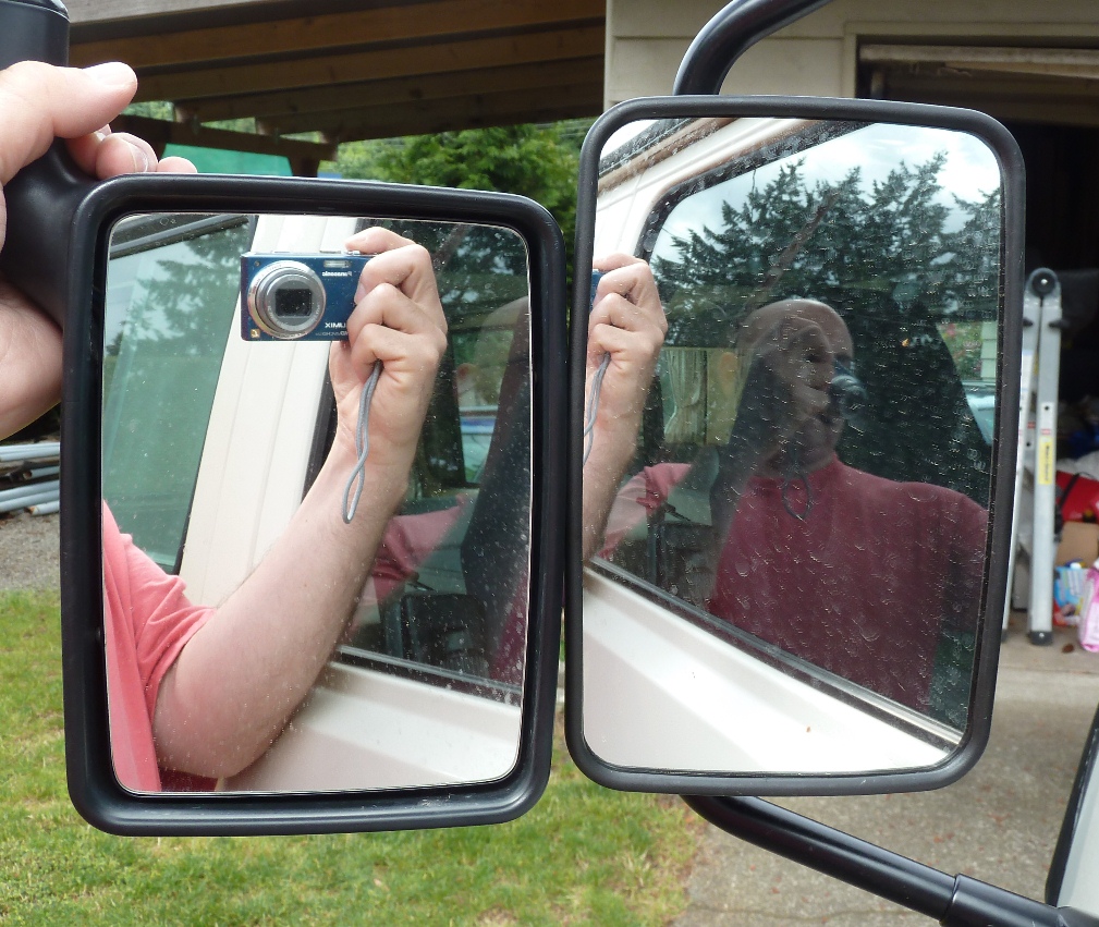

After getting the mirrors adjusted it is now really nice to be able to see back by looking with my eyes and not needed to tip my head down to see in the driver’s mirror. Also it seems that the mirrors have a slight curve to the glass so you see more than with the original flat driver’s side. The original passenger side mirror was convex and would reduce the amount of detail you could see. The new mirrors are great for giving you more detail. You can get much better clarity if you are going to back into something you shouldn’t or if the trailer tire is going to run over something it shouldn’t. Another feature with these mirrors is you can flip the mirrors to extend out another 4” if you are towing something wider or really narrow. So far I haven’t needed to flip them out but I am glad I have the option. It’s probably a 5 minute job to flip them. In town and on the freeway I don’t notice any new wind noise or vibrations.

Comparison, the mirror in the original is about the same width. The camera makes it look bigger than it is.
