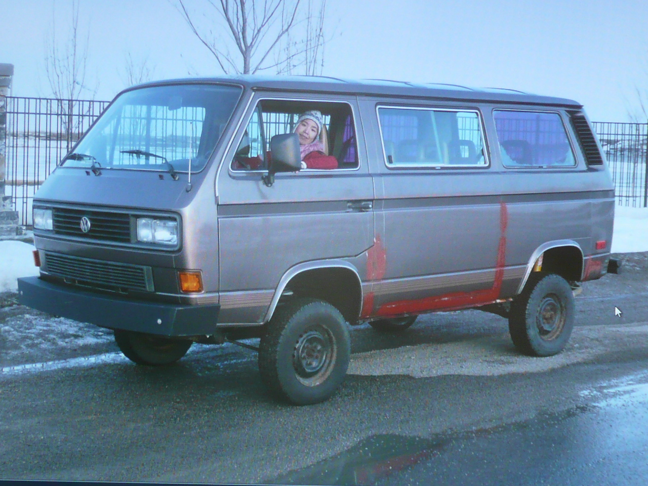

So, here I start with a 1986 Syncro passenger we bought in March, was not looking bad but I should have it cleaned before we bought it...
Some problems with it, nothing too bad, surface rust (I am pretty sure by now, it was not surface rust!), part of the dash unplugged by past owner because of the oil buzzer..... but checked out everything, no oil pressure problem, old van and electrical system, we'll see that later.
Anyway, not a bad van, Syncro, clean interior, we were happy with it.
Here it is, wife is happy since it is going to be her van (that was what she thought....)

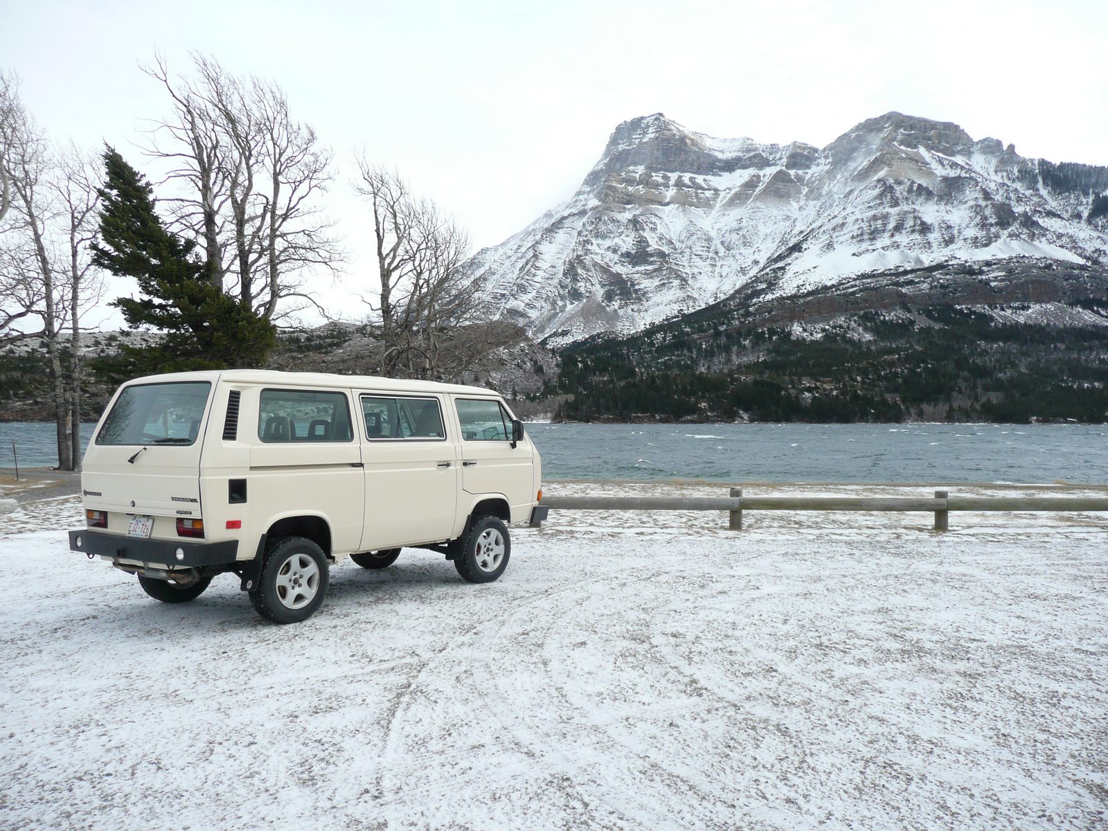

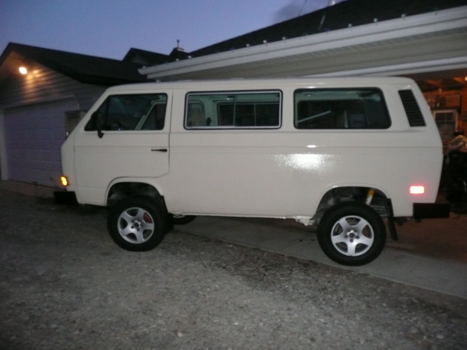

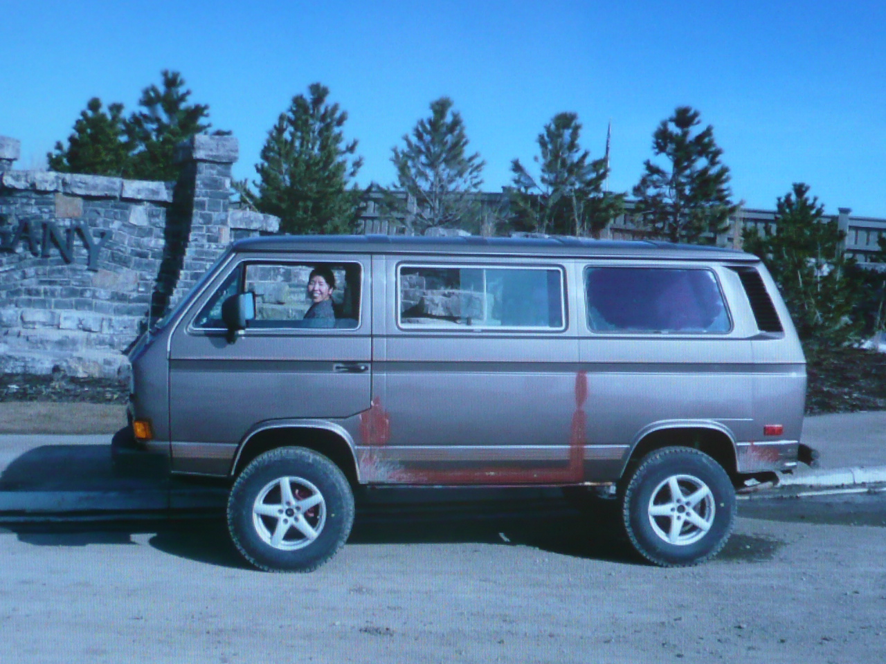

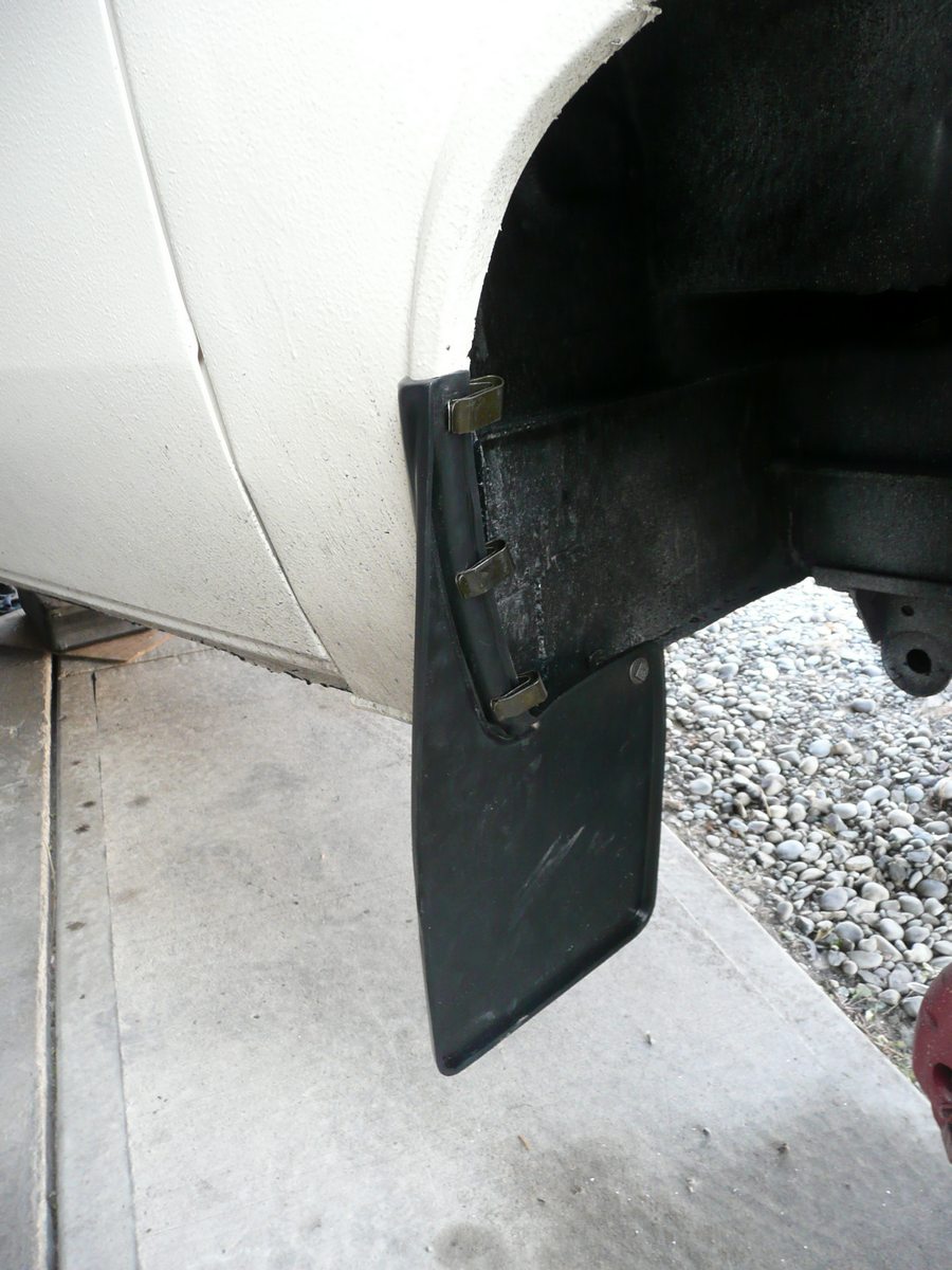

Now, time for those nice wheel (16", rim came with the van), but need tire first.
So, I read a lot and I was not sure but wanted nice tire and having only 4 rims, cannot have a spare so I needed something that shouldn't go flat... and wanted lower RPM at highway speed, of course knowing I might regret the loss of power.....
Here it is. See, doesn't need too much to make her happy...
I know, the front fender look pretty close, but we tried it in the construction site close by and everyhting is perfect, tires aren't rubbing anywhere.
Anyway, there is no plan to go offroading a lot, the van need only to handle non plowed winter road and mountain back gravel road and Calgary's potholes (might need 45 inches tires in some case...).

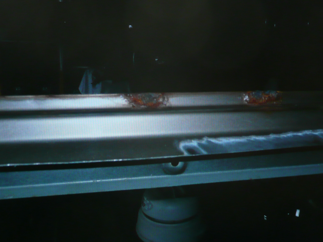

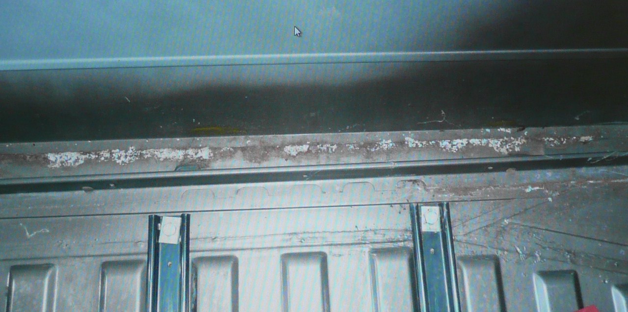

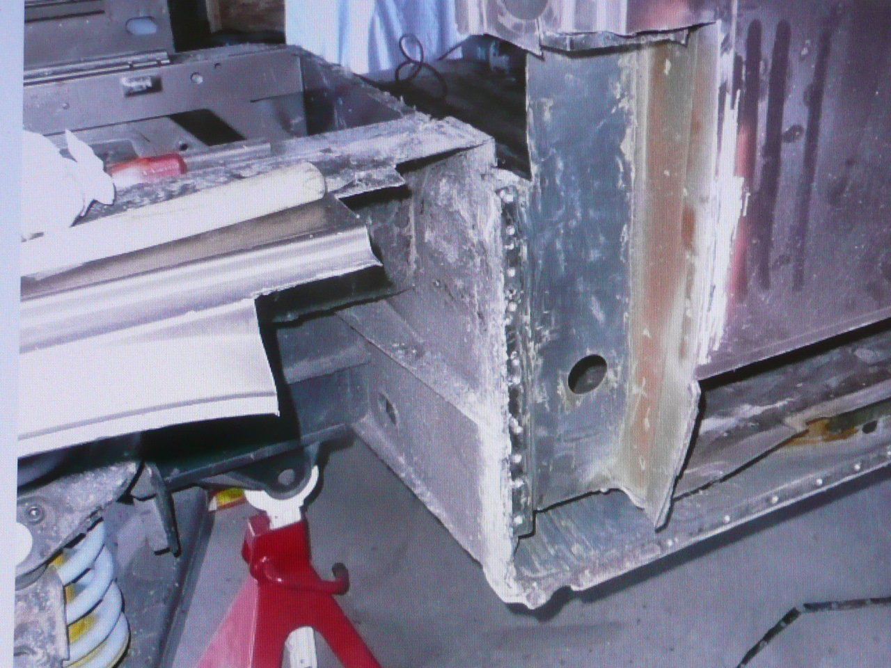

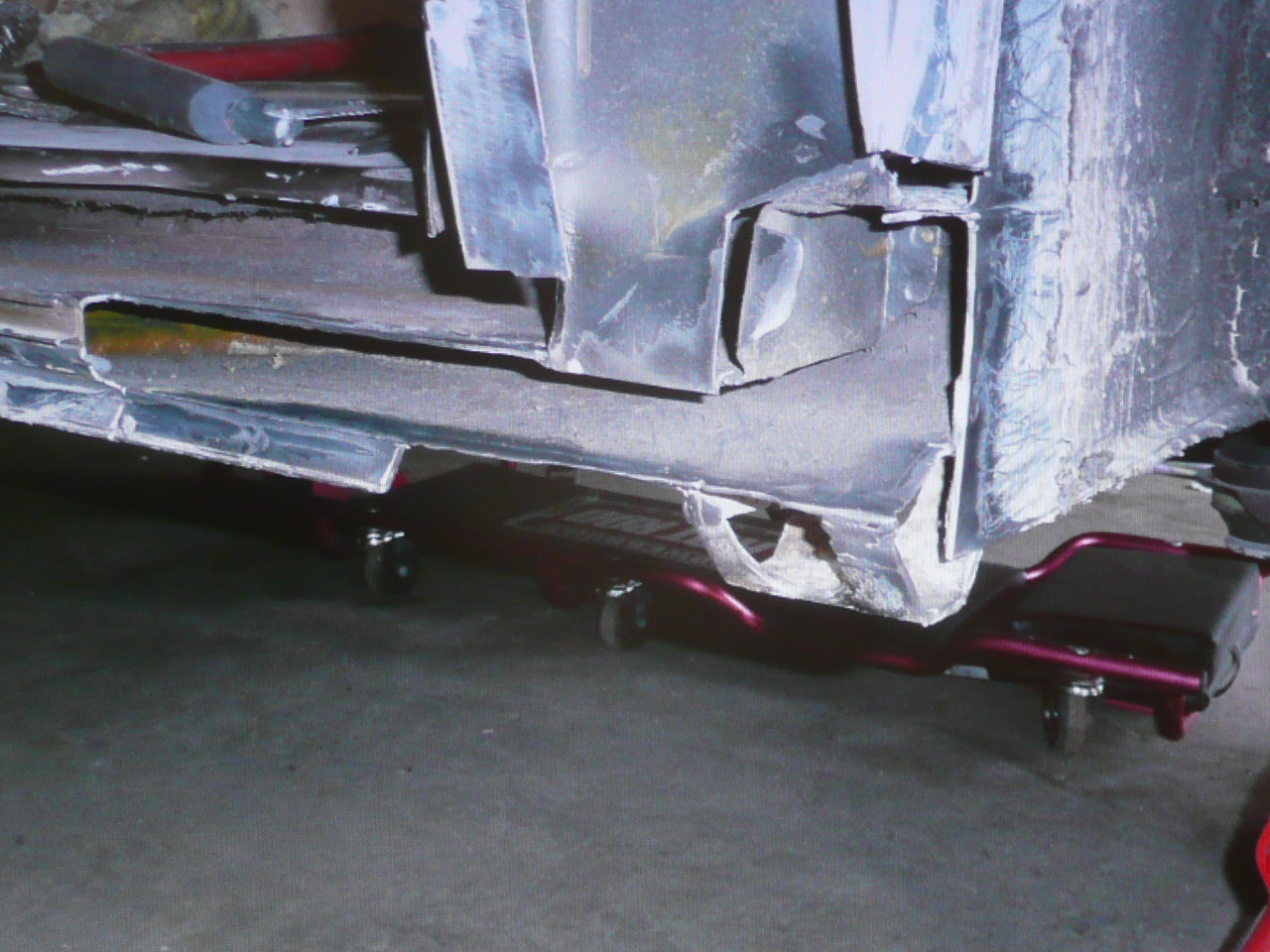

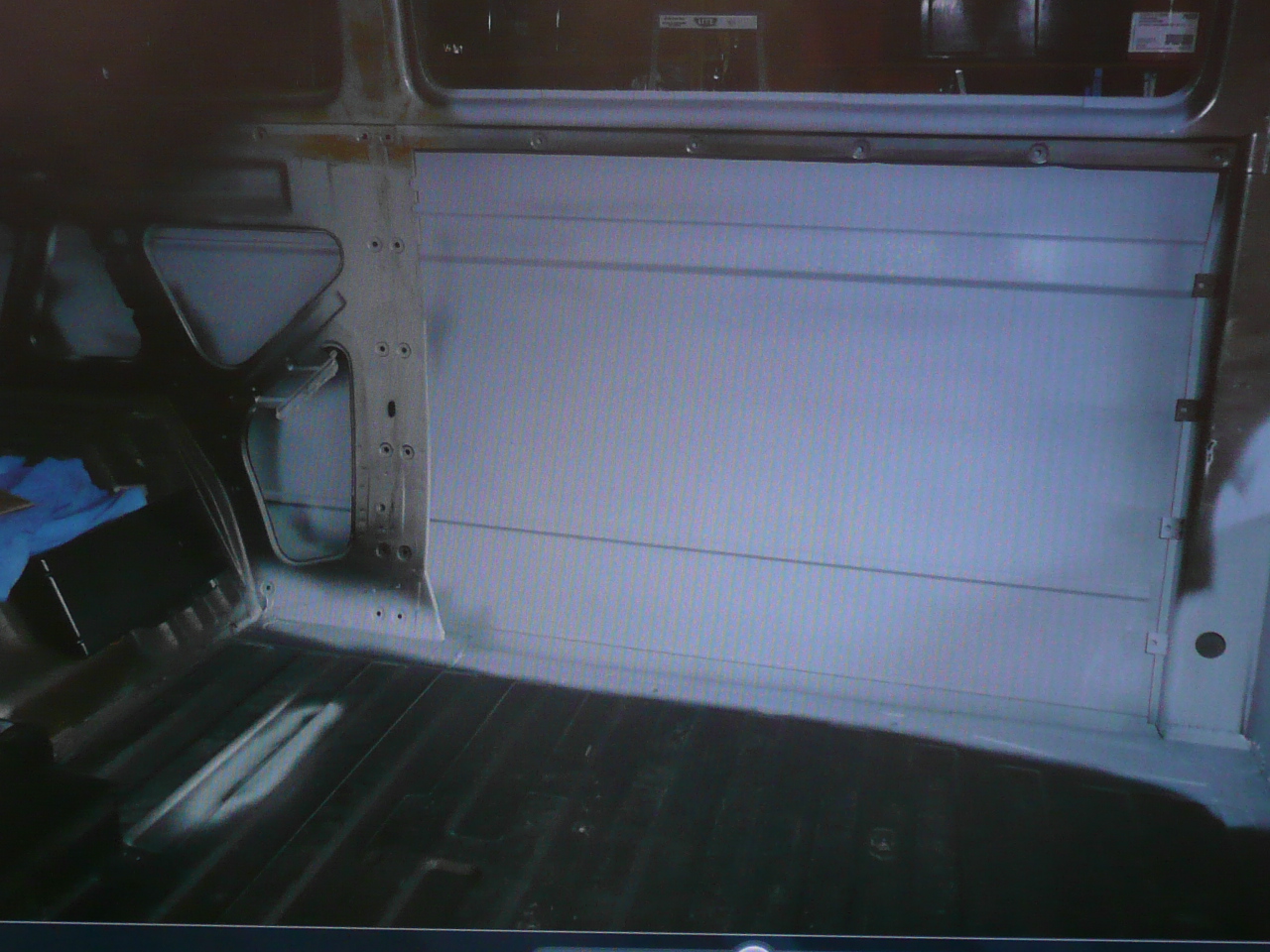

So, after all of that, weather started to get better, time to work inside the van and take care of that surface rust.

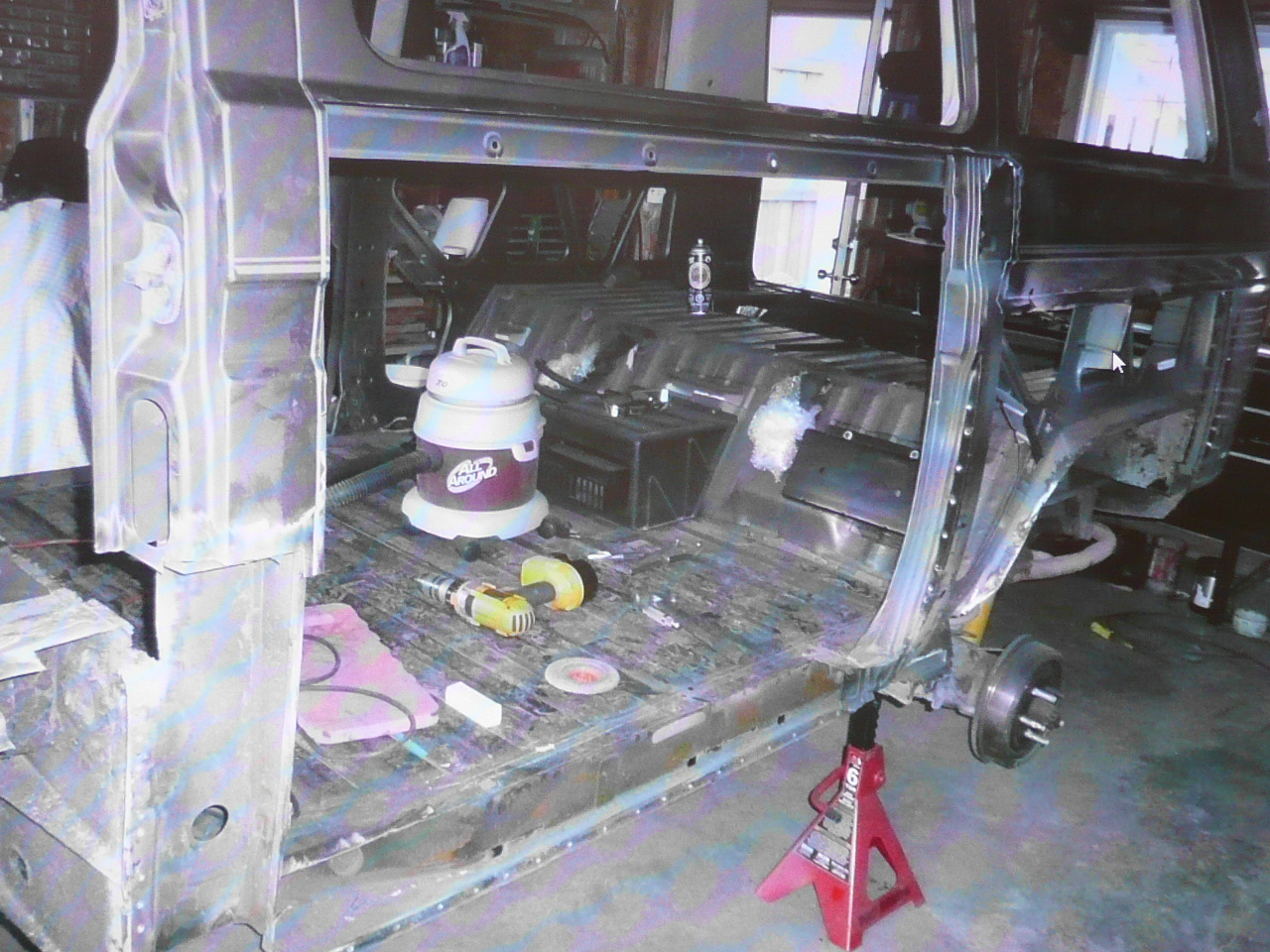

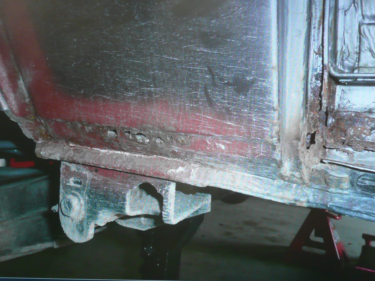

Started with a wire brush and....... go some holes already, time to get the inside of the van out and really look at it:
so I think by now, you get this idea, I did.
On Samba, I was looking at Ben's avatar, and thinking that he might be right.
Thanks Ben, you did ruined my summer and because of you, I need to do it right..... Je plaisante mon homme, tu es toujours le bienvenue a Calgary, je t'offrirai volontier une biere ou meme plus, mais tu risques de m'entendre chialer, voire meme sacrer mais ca va etre que pour 5 minutes...... but at the end, we'llbe so happy to have a nice RUST FREE van, priceless!
So, next step was.... cutting, it cost me a lot in cutting wheel, seriously!
So, I know there is other way to replace metal parts (Ben uses kind of powerful glue-resin) but I discover that later and anyway, I have a welding machine so....
For body parts, not too much choice, not too many Vanagon in Alberta and certainly in bad shape in those junk yard so I bought new body panels I was able to find and made everything else, no choice
I know some persons like POR15 or other, but I am not a big fan, I did buy one of their kit, and I am not really happy. There is no way I am going to look at it next year so I cut everything where there was rust.
I don't really think it is possible to get rust in those seams, I took all of those out and there is rust in really strange place, this is crazy.
I found 2 small spot rust from outside on a side window and had to cut 70cm (about 30") of metal because of the rust inside the panel!
Again, it is a 25 years old Syncro van, in Canada and not a summer sport car resting in a garage when it rains or worst....
So when everything is done, all inside panels, cavity and frame will get a full coat of grease or oil, we are planning to keep this van and I don't really want to waste another summer redoing it.

What size tires are those on the 16'' rims?
Looking good!
bluefirefly
Joined: March 16, 2011
Posts: 438
Location: Calgary, Ab
bluefirefly is offline
PostPosted: Tue Jul 12, 2011 5:33 am    Post subject: Reply with quote
Tire are Dunlop in 215/85-16, load 115/112.
8mm spacers and 56mm stud for rear wheels, clear the side door by almost nothing but I had to rework the trailing arm a little to be safe.
Front fitted nicely but I'll replace those studs later and lugs are from Loogy.
This passenger van have a go Westy suspension kit and sits really tall so it fits, not sure with a Westy....

Looks like a lot of work. I've been tearing into my 86 syncro and dealing with similar rust at the body seams. Previous owner po15'ed the exterior seams but I'm going to grind them down and take the interior panels off and probably have to grind them out anyways. Can't wait to see some more pics...those tires are huge!
bluefirefly
Posts: 438
PostPosted: Tue Jul 12, 2011 6:29 am    Post subject: Reply with quote
That was my problem too and now, I am 100% sure that rust came from inside. I even did find rust under some piece of metal not "connected" to outside (like that little rail on the left side of the second bench on the floor holding the interior wood-vinyl panel or the base of the second bench.
I was surprised because it is a van and not a Westy so it shouldn't be humidity from people sleeping in.
It is really a big job, I am working on it with my wife about 3 to 5h every day after our job and usually the full weekend.
I did some little body work in the past, but not as deep and good as that so we learn as we go, got a lot of tips and ideas from this forum and will see what we'll get at the end but we are planning to make it nice so it might take more time than we thought.

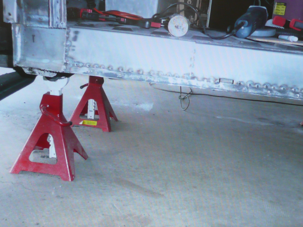

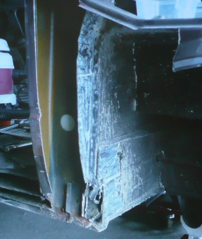

More pictures of the restoration, some welding, primer and body filling and got sidetracked again by the bumper this time.
So, we got some new panels and I looked a little for a donor van but no chance so I took the long way to do it, I had to cut everything to get those rusty seams off and put back some of the good panels from the van.
Not sure if it is the right way to do, but I am doing it for us, not for someone else and my work is free so it is not important.
Some heavier gauge for those jack support, I had to redo all 4, it wasn't that bad but it was rusty outside and I had no way to know if it was from inside or not. I was wrong, still a lot of factory grease or wax inside those support and frame but the rust outside was enough for me to decide to cut.
I had to made a lot of parts that aren't available, tried my best and it should be ok, but a side by side comparaison will make my van look a little different.
I wanted to correct some factory defect (panel not perfectly welded together) so I spend a little more time on it.

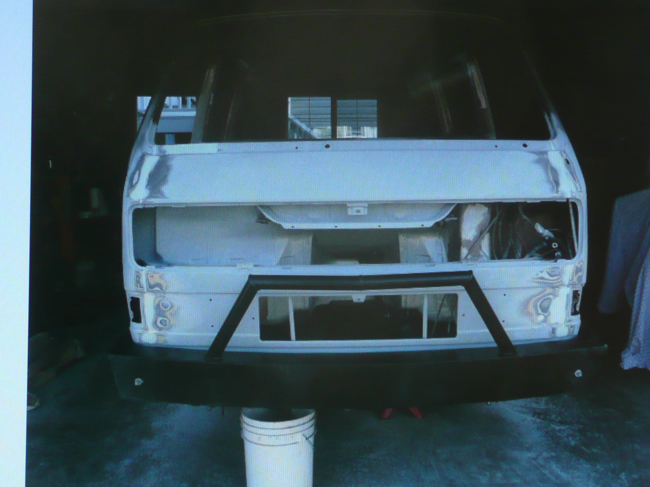

Now a break from panels welding, I looked at that front bumper.
As I said before, this van has those headlight relays upgraded but I am not really happy so the plan was to add driving and fog light.

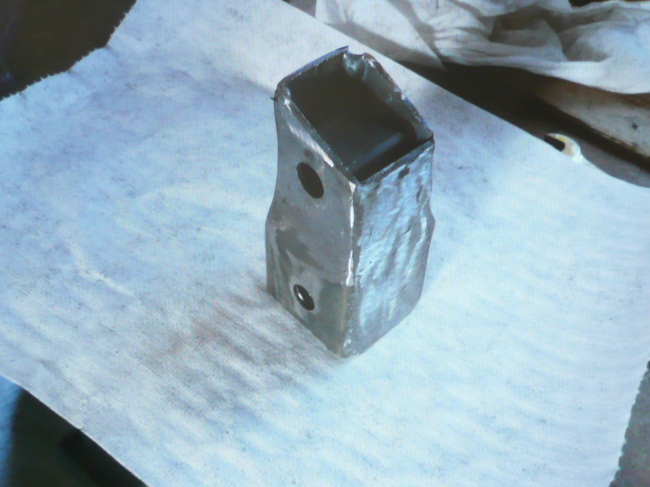

This bumper is I think from Go Westy and I wanted to make some protection for those light, but not a bolt on, I wanted something stronger.
So, I got some 1/4" flat, 2" pipe (3/16" wall) and 1/8" flat to put under those light.
So, I had to drill the bumper and the 1/4" flat to be able to insert the pipe in the bumper and weld both side.
Pipe has been welded, I don't have a pipe bender....
Of course, there is flat plate in front too so the bumper is stronger and I shouldn't have the pipe coming in my radiator in case of a low speed touching.
Another project for later will be to add a skid plate from this bumper to the front axle since I am not going to use a spare.

purplepeopleeater wrote:
bluefirefly wrote:
Thanks a lot.
This is Honuak's Vanagon, we really like the color but I don't think I'll go with that much black, especially around all windows, but the black part under the windshield look really nice.
Anyway, we have some time to think about it, paint isn't for tomorrow, may be next month, depend how it goes, I still need to rebuilt the motor and almost everything else.....
My van is the same color, I think i'll do the same amount of black except around the side windows, ill be using bedliner instead though.
I might go the same way, kind of undercoating that can be painted so if it is too dark for us, I still could paint it the van color after all.
Not sure how high it will be, certainly up to those fenders since I "cancelled" the line at the bottom of the body.....
