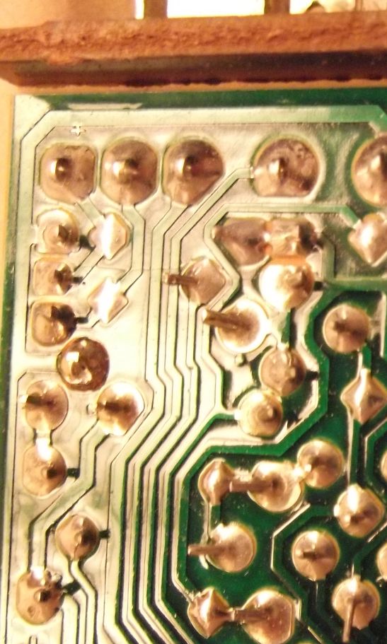

Dose anyone have a photo of the green side of the board, mine is burnt and I can't see the copper tracks, one of my contacts is gone and I have to jump the track for the transistor
Thank
Steve

PostPosted: Thu Jul 21, 2011 8:43 pm    Post subject: Reply with quote
Thank
Steve

Bassyaks
Joined: October 06, 2010
Posts: 1145
Location: S.E. Connetitcut
Bassyaks is offline
PostPosted: Fri Jul 22, 2011 3:05 pm    Post subject: Reply with quote
Thanks guys, great photo it should help.
