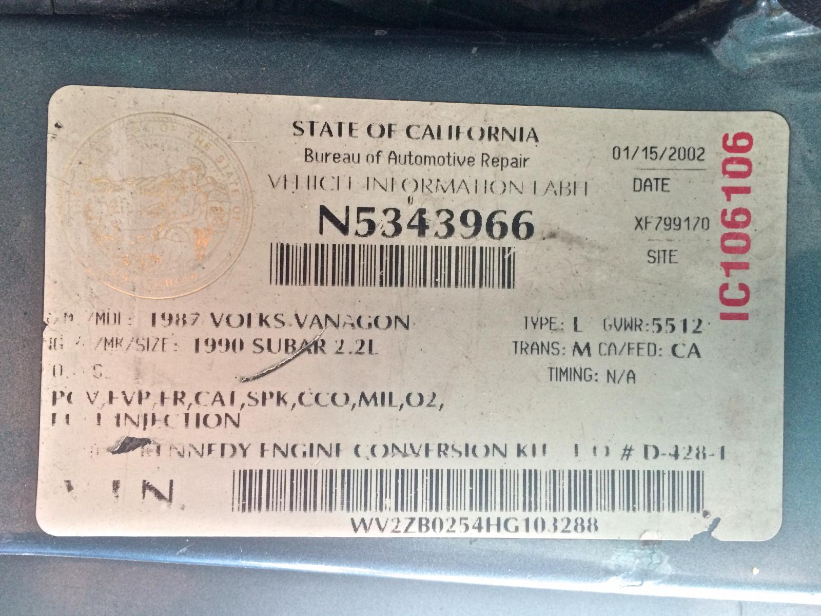

The van I purchased came out of Monterey. Since I live in Utah I don't need it. But if I ever sell it, it can come back to California to a happy owner.
This conversion was done back in 2002 and I just replaced the engine last year with a 1994 EJ22 that was totally rebuilt at Metric Motors in Ogden, UT. It purrs like the day it was born. Very Happy
I added the tag so you can see the site on the tag.
