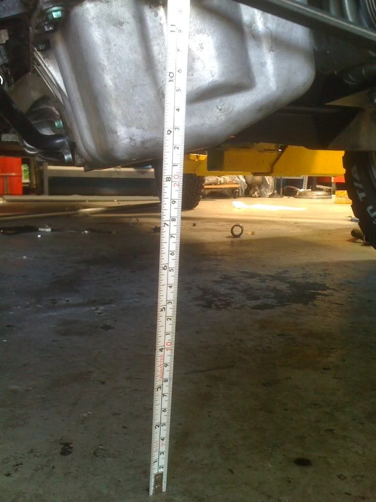

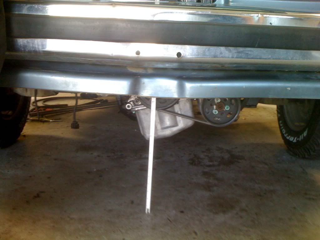

A question for you happy 1.8 t owners - how low are you hanging?
Can you measure the lowest point of your engine / engine mount (in inches) and post it here please? I'd like to see your ground clearance in inches.
Oh, and tell us if you are syncro, lifted rear end, or pretty much stock rear suspension.

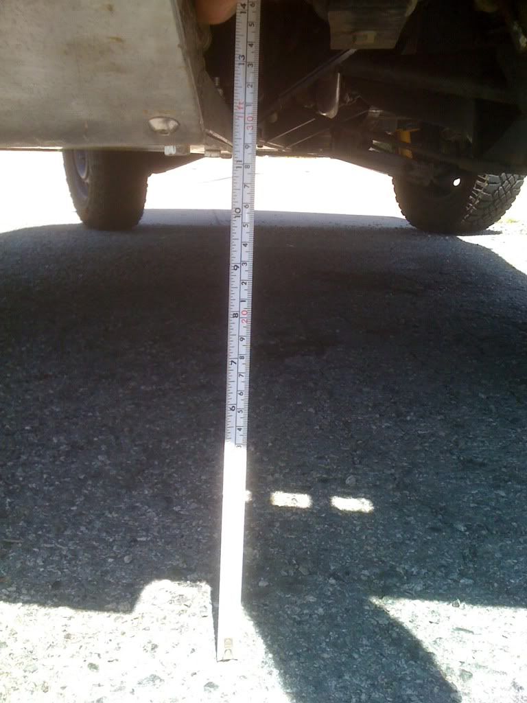

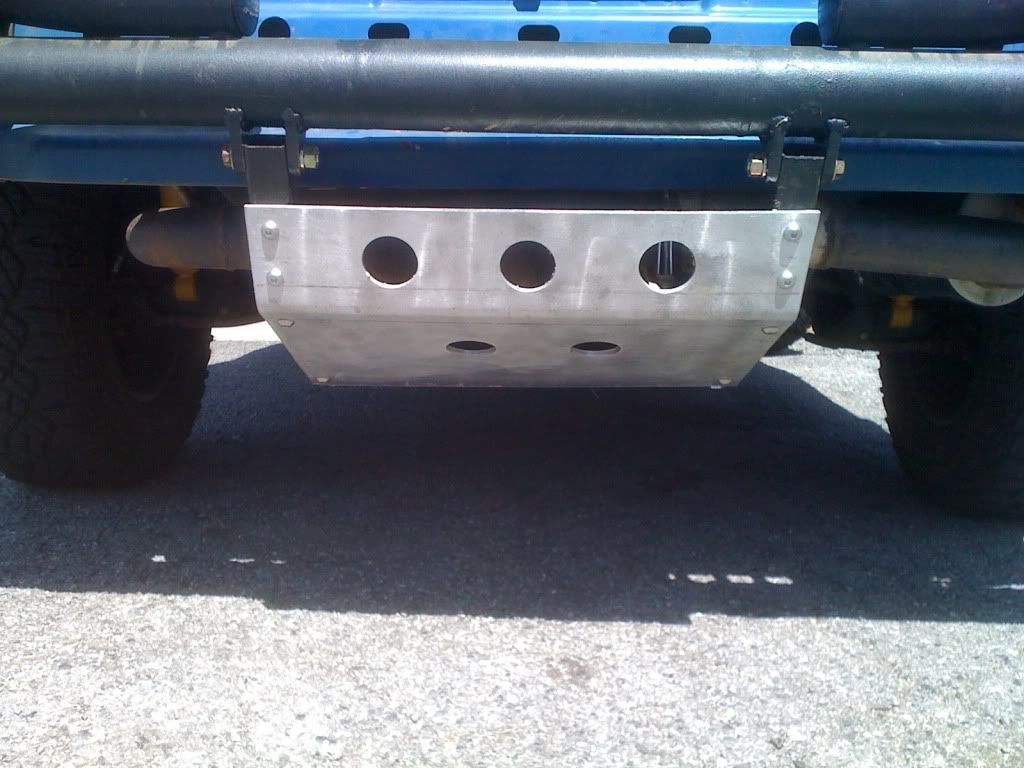

Here is a 85' 2WD I'm working on. As you can see in the pics it has 8.5" of ground clearance with stock suspension and slightly over sized tires.Tires are 215 75 15.
Plenty of clearance for a 2WD, but if you want more just put a bigger tire and taller springs.
The Single Cab Syncro has over 11" inches of ground clearance with the skid plate I made.

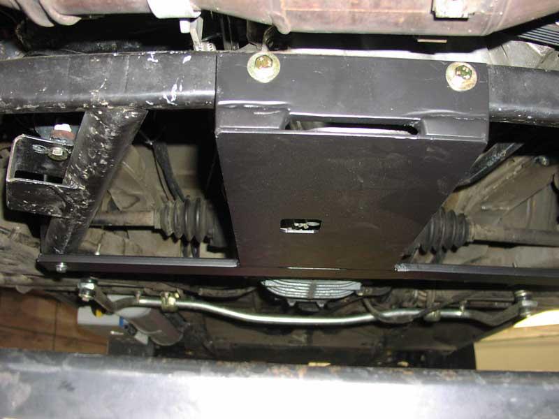

Paul did you end up taking any DIY parts for this conversion to SyncroFest? I remember you saying you might. I never read or saw any pics...maybe I missed it somewhere? Love your single cab too! Such a beaut!

PostPosted: Wed May 04, 2011 3:42 pm    Post subject: Reply with quote
Yes I was showing the 1.8T DIY engine carrier bars at Syncro Fest. Here's a teaser.They work for Syncro's and 2WD.

Clearance is 9.5" to the bottom of the *stout* skid plate. That's with the engine lowered the same as a Syncro + skid plate (about another inch), GW springs (18" fender to hub), and 215/70-16 tires. Not planning to offroad it so 9.5" is way more than enough. If I'm in a situation where I'm scraping the skid plate, I'll be far more concerned about the unprotected tranny.
Like I mentioned before, cost is a big factor. Likely a limiting factor for most non-DIYers. The same could be said for having someone install a Zetec, Subaru, TDI, etc. At the time of my install he was just getting started and in truth, he didn't charge me enough! The conversion cost what our friend recently paid for his 2.5. It was also the only California legal offering over 120hp. Still is I think.

11.75 inches clearance to the lowest point
Go westy 2" lift springs
225/75/R16 Nokian Vattivas
