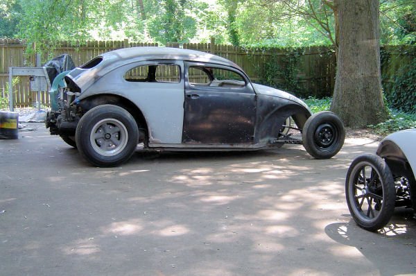

PostPosted: Fri Aug 05, 2011 6:10 am    Post subject: Reply with quote
I have a VRod project in the works. I wish I had a dollar for every time someone said,,,"Hey,,you dumb%#@*,,your on the wrong website,,,you need to be on volksrod where they might give a sh*&.
Build and drive what you want. Very Happy

I wish I could chop a top like that-
Hard work, eh?

You sir,,, have the ultimate!!!!! I tip my cone cover to you!!!!!

PostPosted: Fri Aug 05, 2011 4:15 pm    Post subject: Reply with quote
Thanks yall. One area that took us about a year to get right was the "HUMP" around the tank. A trick that we found was to take the rear inner fenders, remove the body mount brackets, then swap left for right, then use them for front inner fenders.
WAH LA! The hump is gone. Theres nothing wrong with the factory hump but we wanted it to look a little cleaner.

Thats more work than this fat old man is ready to take on!
