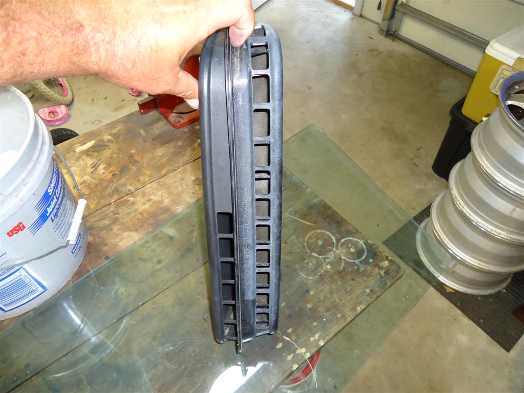

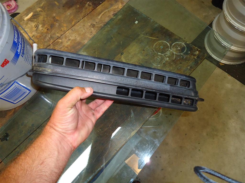

Is this molded into the window. Can you take off the plastic piece and leave the window in? I would love to know more about these things or if you have pictures of these when open. I want to change the filter but now I am very curious to the construction of these things.

The plastic piece replaces the section of glass that was "removed". You can't take it out without leaving a hole where the vent would be.

It's almost always some sort of dried up foam. Stuff turns to dust if you look at it wrong.
Oh man that is awesome thanks for posting those pictures!!!
So do you just cut the new foam in strips and stuff it in there?
