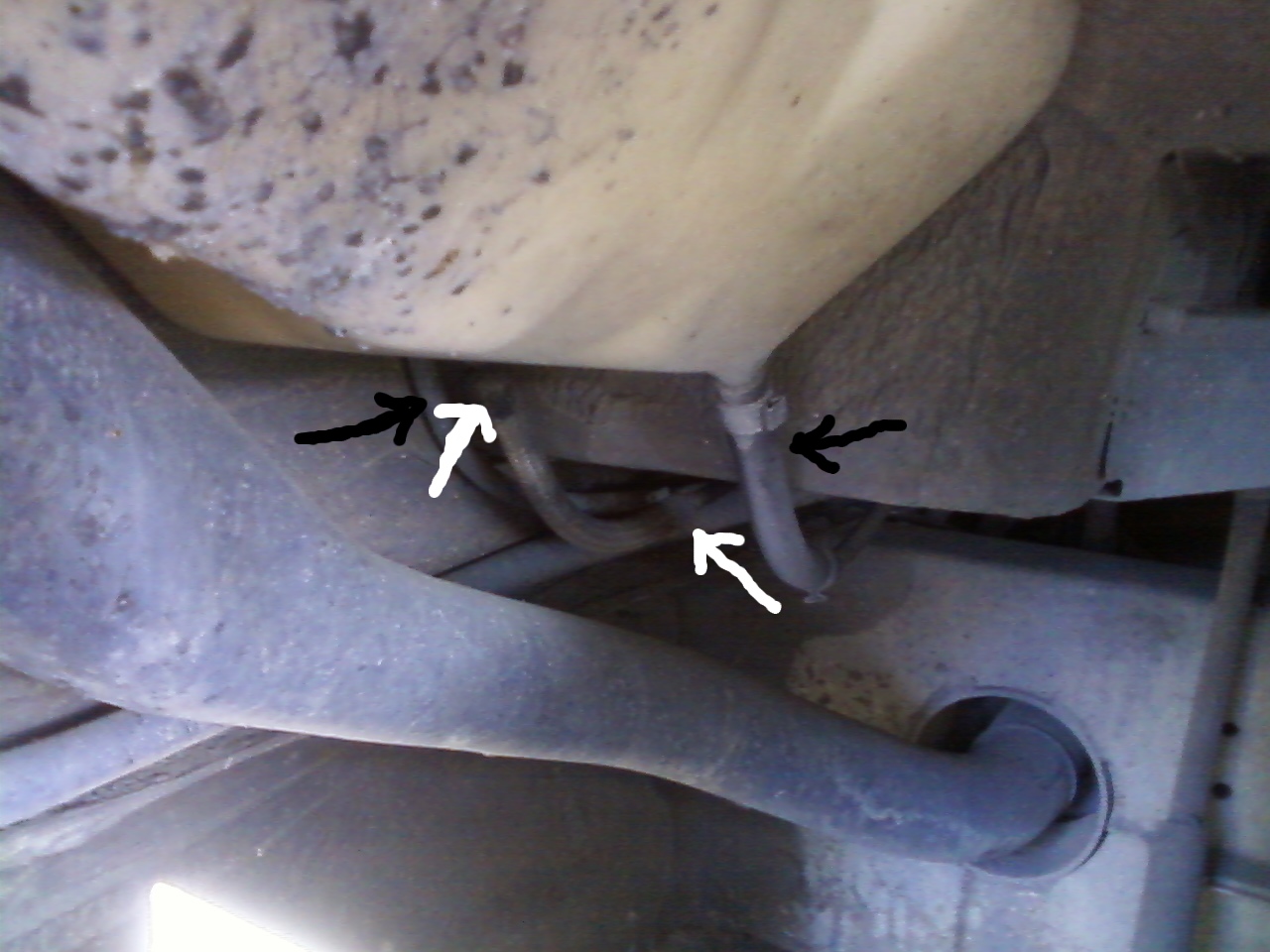

Posted: Fri Aug 12, 2011 8:24 pm Post subject: Braided and rubber line |
Found this thread just in time. I purchased one foot of rubber hose today, and was going to ask if it's OK to replace the braid with rubber, as my 86 has one of each!
Just to add to the knowledge base should anyone else encounter a similar set, here is a photo of the mixed tubes. The white arrows indicate where the liquid gasoline drips out after a total fill up. The drips and fumes only last a few minutes, and if I drive just a few miles they seem to be gone.
I'll be replacing the line this weekend, and raising a complete tank reseal way up the to-do list with my mechanic. Some of those stories scare the pizaza out of a guy!
I'm planning on using standard worm gear hose clamps. Any problem with those for this application?
Thank you in advance for any input.
