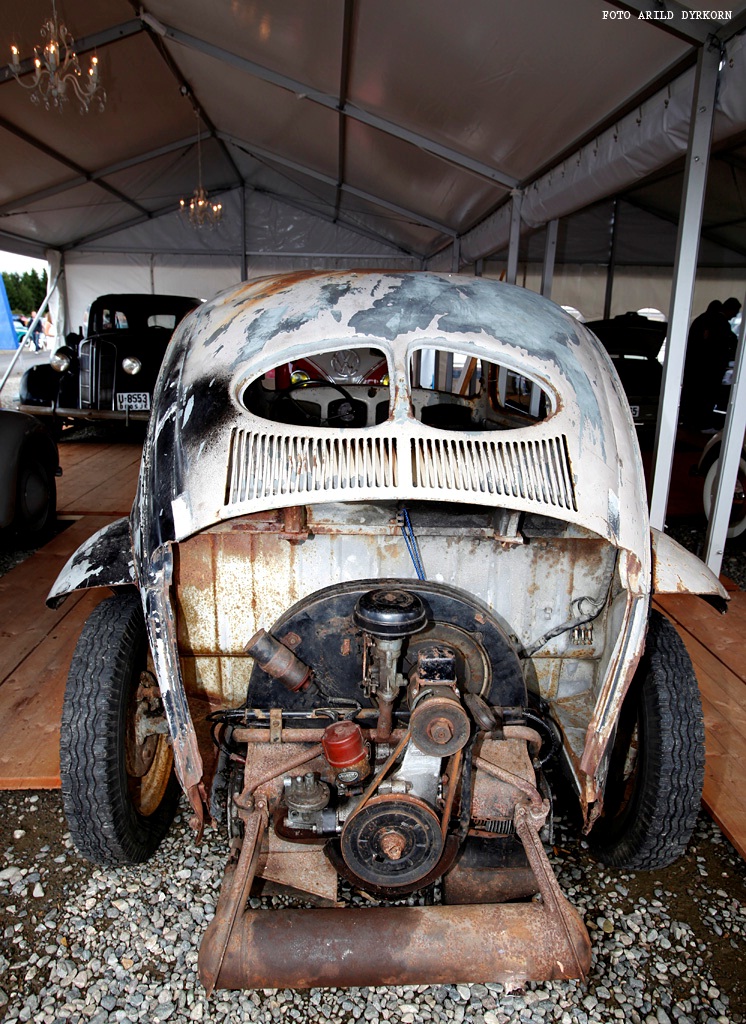

I think you are right about the franklin; This picture shows my mid-June-1949 engine which is basically untouched since that time.. Non-jacketed, undoubtably.
