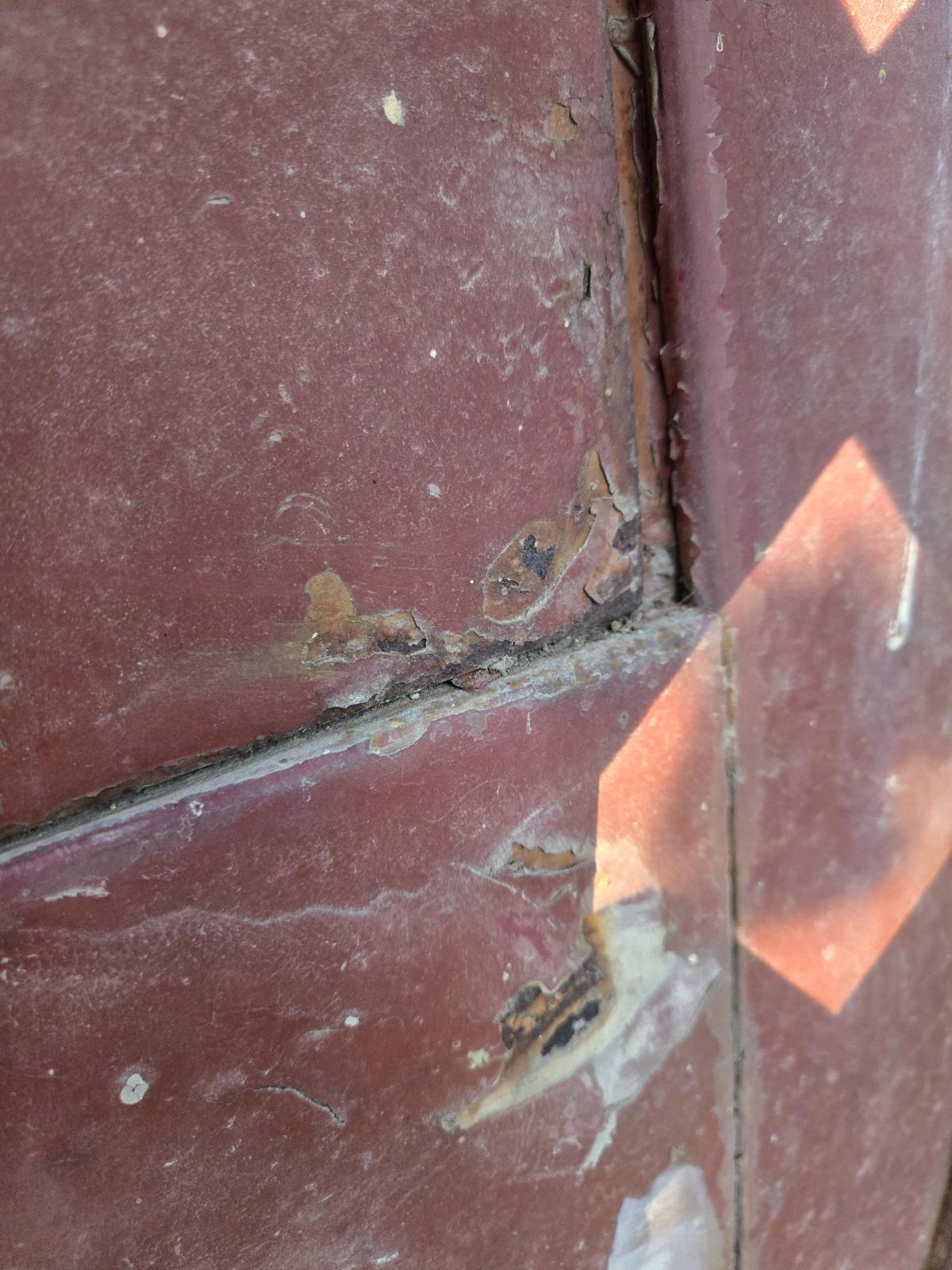

PostPosted: Mon Oct 21, 2024 9:35 am    Post subject: Reply with quote
I looked closer and that door's bottom hinge is off. Heres's the drivers sides
and then passngers
I have a spare used door that I will try to swap it out with and I'll see what that does. I hope the A- pillar isnt damaged! Thanks for the replies and tips!
-Karl
Stocknazi
Joined: June 18, 2004
Posts: 5460
Stocknazi is offline
PostPosted: Mon Oct 21, 2024 12:20 pm    Post subject: Re: Sprung door? Reply with quote
Have someone hold a 4x4 on that lower hinge, and give it a couple wacks with a big hammer. It'll pull the A-pillar back out at the same time.

PostPosted: Thu Oct 24, 2024 7:22 am    Post subject: Re: Sprung door? Reply with quote
Yeah - the front panel flange should not be bent around the hinge at all....
