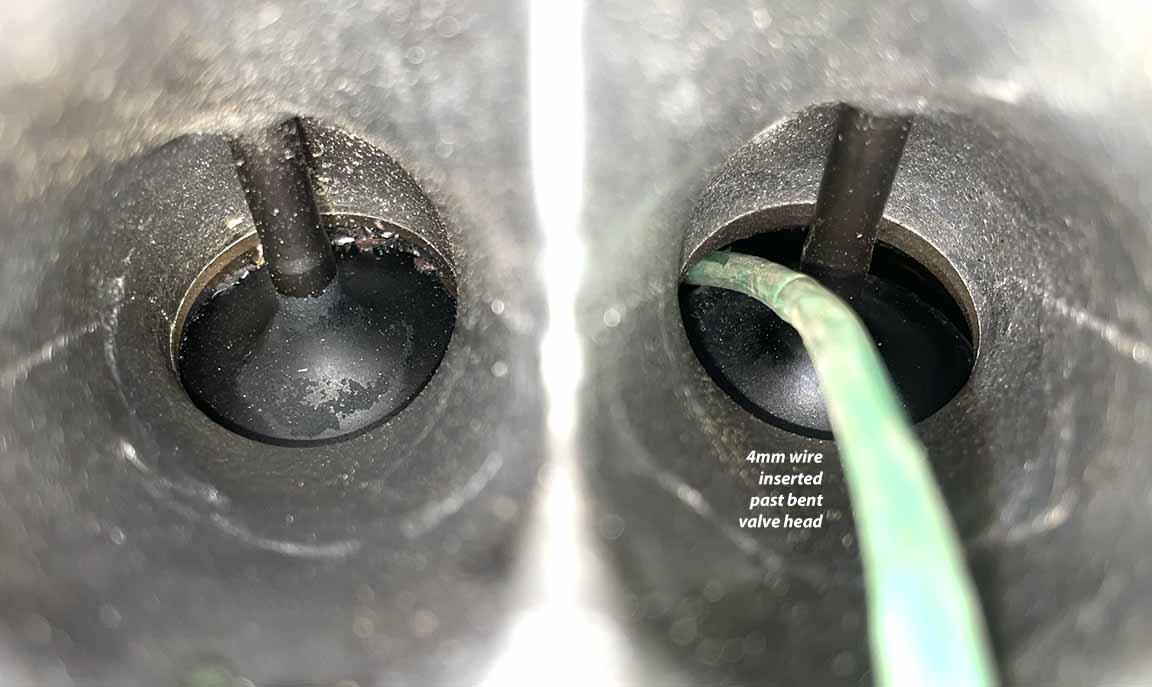

The timing belt jumped a few teeth and bent some valves.
See other thread: EJ25 timing belt skipped a (few) teeth. See this PSA (video)
Four intake valves were bent. Here's one.
The other intake valve was not being used because this engine uses only 3 valves for low RPM.
At some higher RPM little hydraulic cylinders push a latch and engage a tappet, and the 4th valve opens.

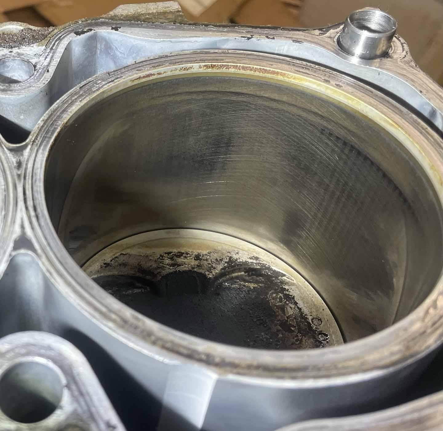

The bores look good (to me) with hone marks remaining, all the way around and zero detectable ridge at the top.

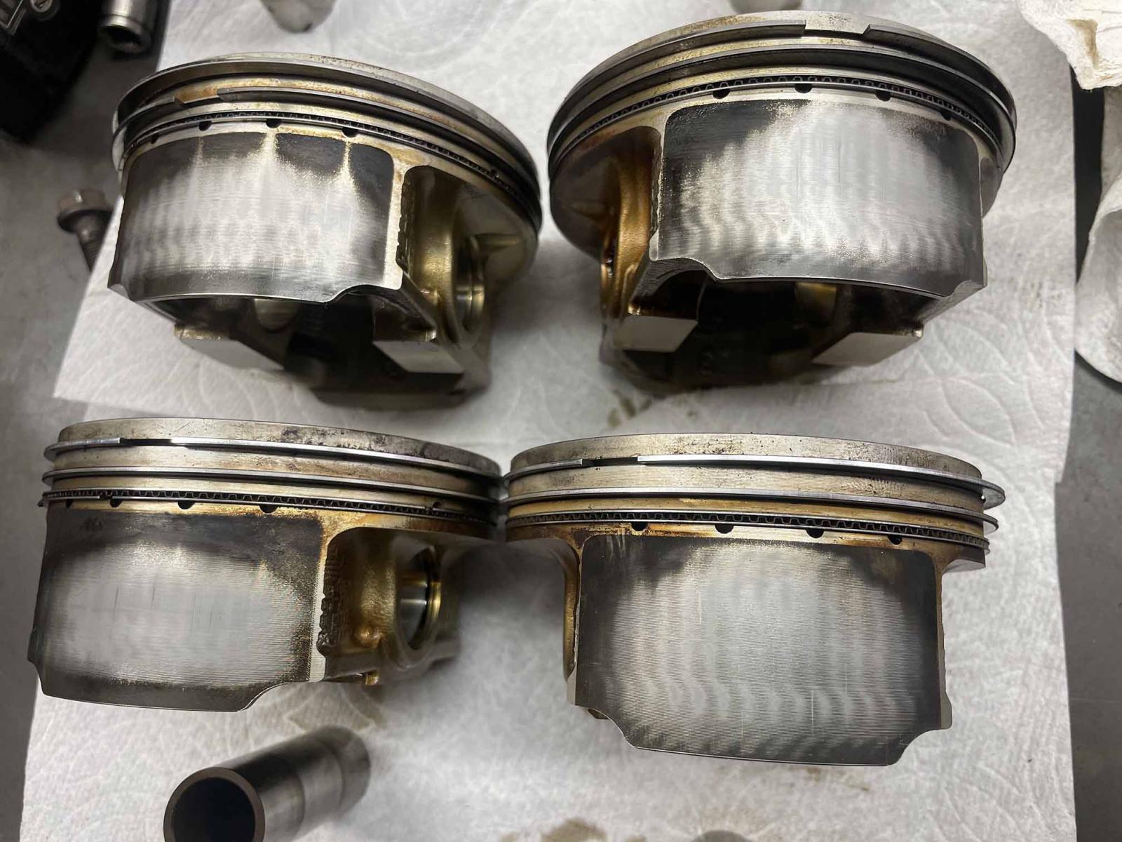

Here's where I'm at this evening.
My worst piston. All others are less worn.
You can still see the original machining marks.
To me, this is 'good".
Curious what a real mechanic says.
Also I expected the oil rings to be "coked up".
They look clean to me.
But they look much less "energetic" than the compression rings.
Again, what does a Subaru mechanic say?

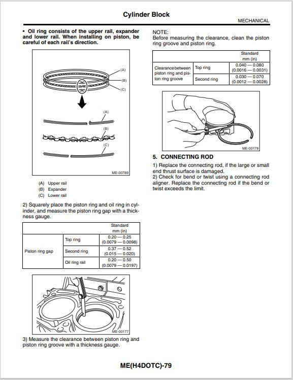

I will put them in the bores and measure the gap.
Does anyone know the EJ25 2010 ring gaps?

As a guess, as shown in the image, skirts et al of 2 pistons at LH of image look more worn than pistons at RH side.

If the original hone scratches are visible all the way around, do you think there could be measurable taper? The Ring Ridge at top is “zero”.
I was told not to use a ball hone when diagnosing oil consumption because it obliterates any out-of-roundness evidence that I need to see.
Dang I don’t have a rigid hone.

2005 EJ253 Ring Gap - I would "Assume" the same for your block

It's interesting the verticle lines on the pistons show up in the cylinder walls as well. Can't tell if the piston skirts were factory coated or if that is some sort of build up. I also find it interesting that the one piston shows the lines directly aligned with the oil hole in the bottom ring land and the oil ring expander edge is over one of the holes.
Unless you are buying oversized rings that need to be fitted, I'm going to guess you are stuck with the end gaps you get. There is also a formula you can use for determining ring gaps that will get you close.
Top ring, Bore x 0.0045"
Middle ring Bore x 0.005
so what if it obliterates? you aren't going to replace the cylinders regardless of what showed up, right? because hone marks aren't the correct measurement tool to determine that. besides, there's no way a hand drill operated rigid hone is going to straighten out cylinder taper anyway. you need a true machine shop Sunnen type hone to cut straight.
whatever honing method, just keep cleaning and cleaning until a new paper towel comes out without a hint of darkness on it after wiping.

Oil rings became narrower and had less tension to reduce friction improving mpg. That yours don’t seem to have a lot of tension would not surprise me.
Set 1st ring at .007" to .009"
Set 2nd ring at .002" to .004" larger than 1st ring.

DanHoug wrote:
Not using the hone as a boring bar. Wink
He was saying that the rigid hone can informs you where it's out-of-round.
Whereas the ball hone obliterates that useful info.
Thats something I’d be inclined to do.
