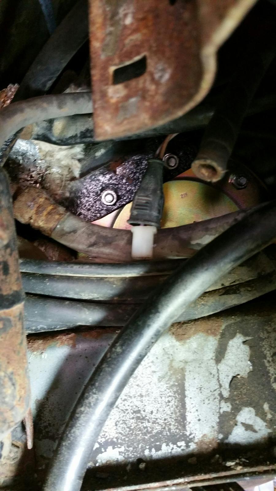

Has the tank been out since you took this picture back in 2018?
https://www.thesamba.com/vw/forum/viewtopic.php?t=698252&highlight=
Maybe provide a couple recent pictures of how things look today. General pics of the area and where the fuel is leaking from specifically.
If the Syncro hasn't been driven enough to cause sloshing in the tank then most likely the leak is coming from the fuel return line. Any chance a vent line was mis-routed?
Currently:
