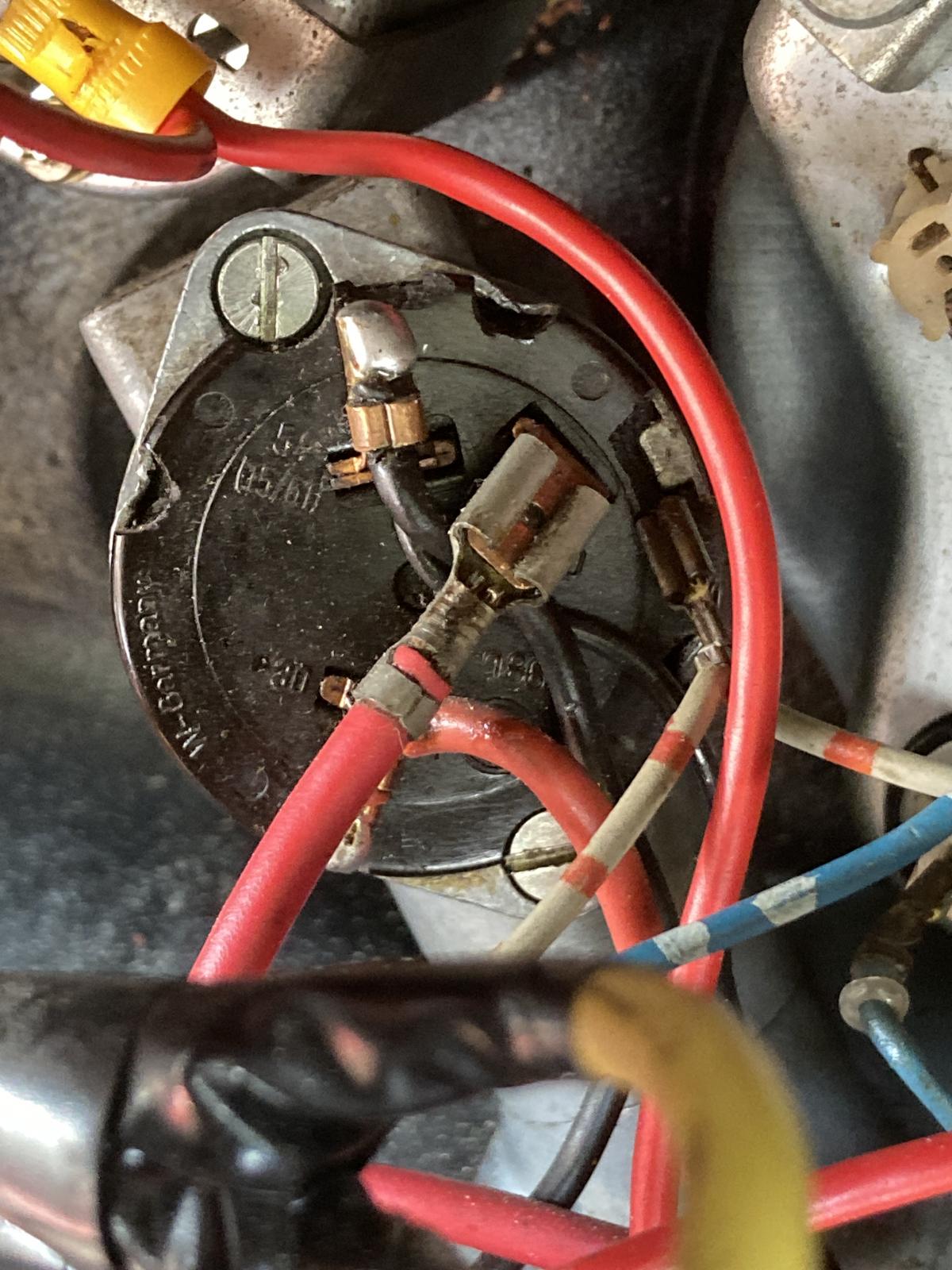

Dear forum. I've had my ignition/starter switch acting up a bit. Contact spray has solved the acute problems so far - but a more permanent solution is wanted.

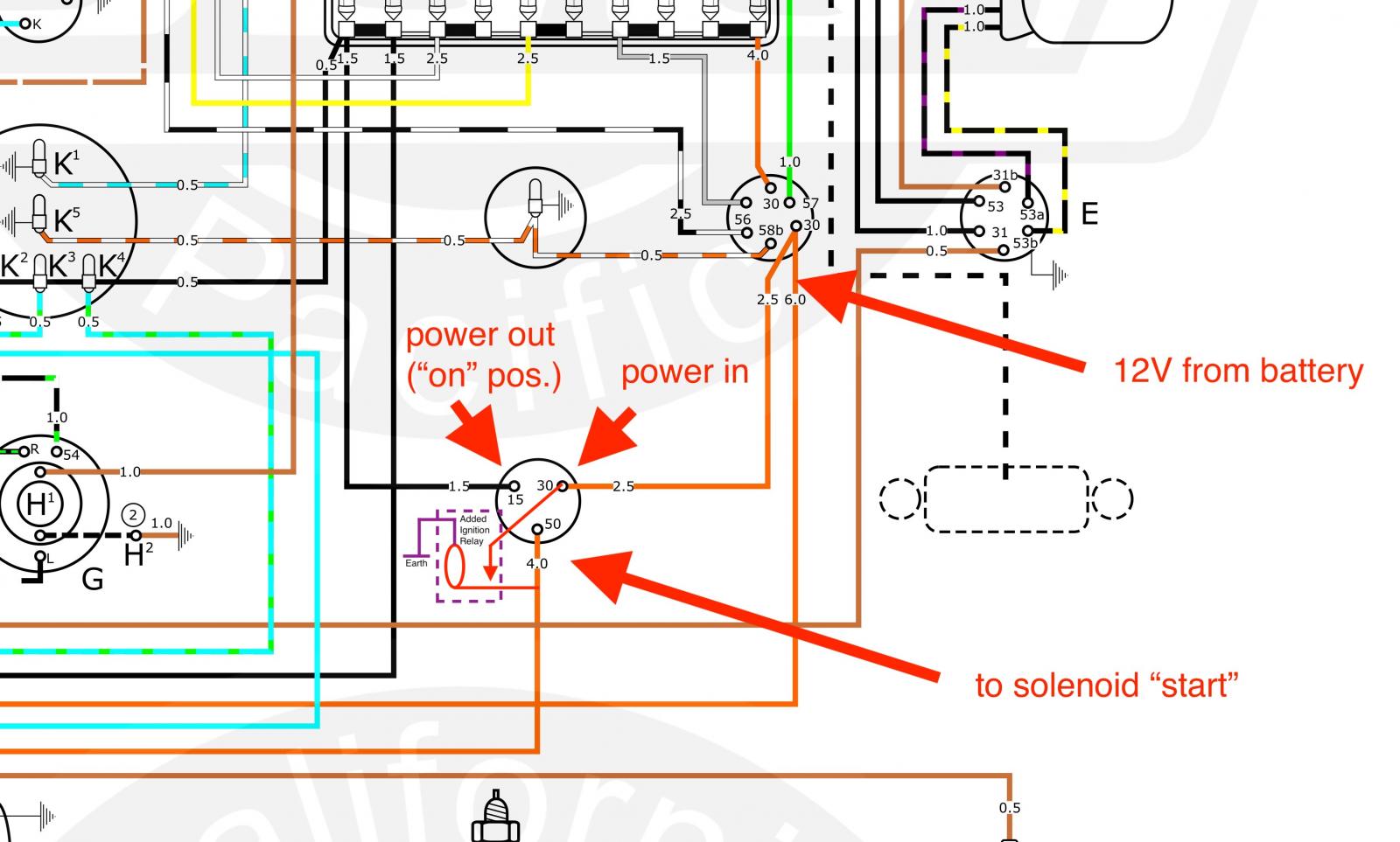

1) Do you recommend a parallel relay circuit to the starter switch?
Benefit: This could easily also be used with a separate switch in case of malfunction.
2) Is there great variation in quality of the switches available? So far I've been looking at the Heritage Parts switch. Has anyone experience here?
Including pictures of a relay schematic and the present switch.
Not a parallel relay but just the relay. This relay has a name. Hard Start Relay (HSR). A quick search in both the Forums and Gallery will supply you the answer to your question. As for the #15 wire on the key switch, it would be better for the switches remaining 'life' to have it control a relay with #30 on one contact and #15 on the other contact to the fuse panel. #15 from the key switch to the coil of this relay and of course ground on the other side of the relay's coil.

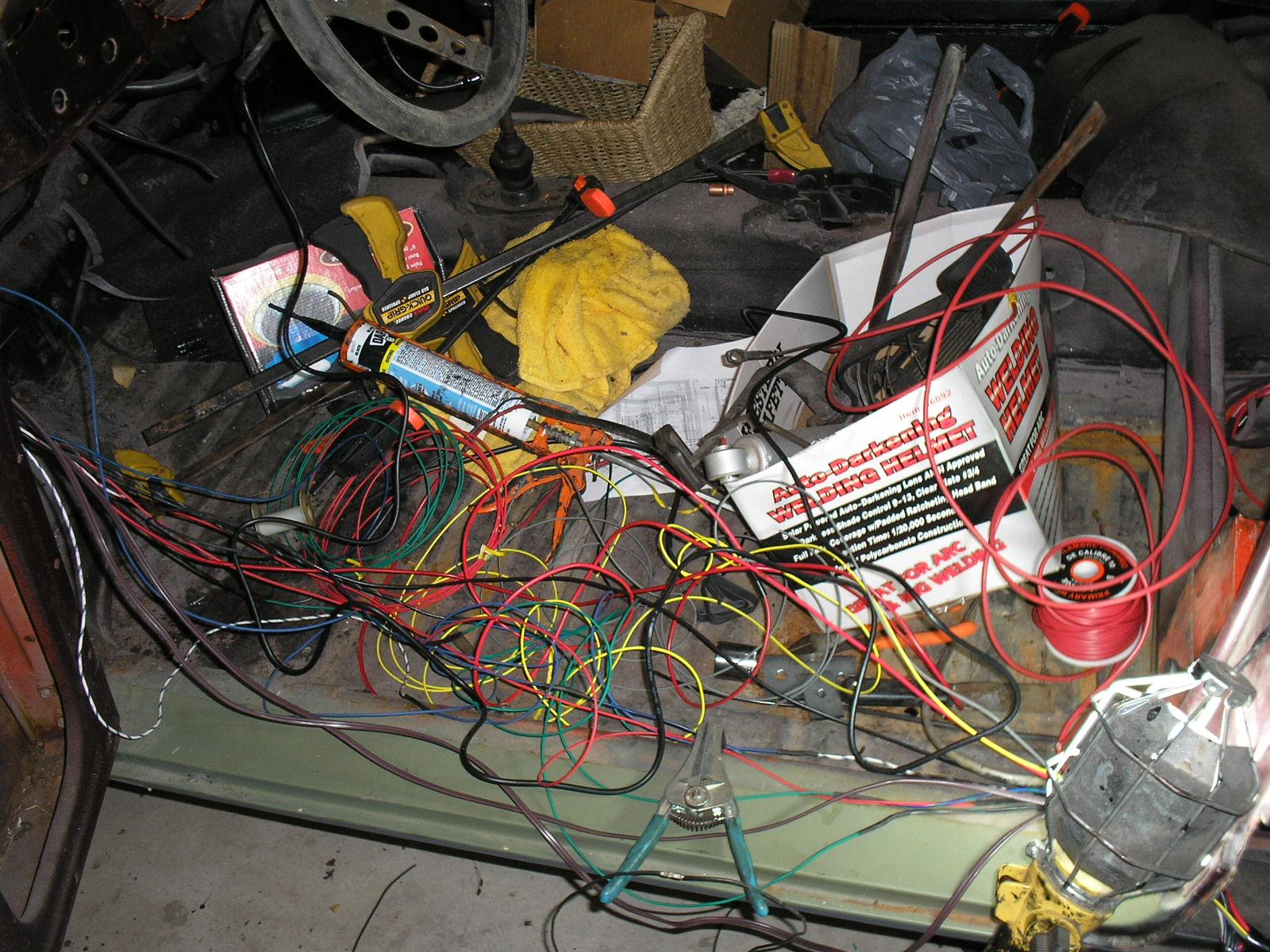

This is how I wired it on my '69 (similar on a '66-'67 set up I'm sure):
If you have an original ignition switch, it wouldn't hurt to install both a hard start relay and run relay to extend the life of that switch.
I made my own wiring harness with 'modified' wire gauges. I ran a separate #30 from the battery to the key switch (was #50 wire now #30) and another to the light switch (original #30 wire). The HSR is under the rear seat, ran a 18gauge from the key switch (new #50 wire) to the coil of the HSR. Haven't had to change the #15 from the key switch to the fuse panel with a relay. (I replaced the electrical part of the original key switch)
All of the headlights, running lights, dash lights and optional fog/driving lights have their own feed from the battery.
The other #30 feed from the battery, that goes to the key switch and powers the stereo, dash clock, and fuse on the left.
The #15 circuits from the key switch feed...horn, turn signals, brake lights, wipers through the fuse on the right.
Not a big fan of 'daisy' chaining wire connections. Every circuit that goes to the battery has it's own wire going to the battery.
These wires can be moved around to do other than 'stock' stuff too. You can put the brakes and horn on #30 and they will work without the key switch 'on'
I wired my VW the way the Germans would have done it if they didn't have to worry about what it would cost to do it on 25 MILLION cars. Cool
Remember it's just wires Wink
