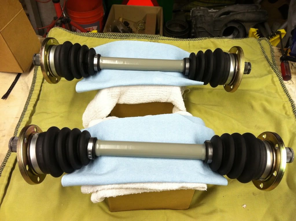

curtis4085
Joined: July 22, 2011
Posts: 4806
Location: Colorado
curtis4085 is offline
PostPosted: Sun Nov 27, 2011 6:00 pm    Post subject: Reply with quote
make sure to put a new boot on it when you replace the cv. Rochford has some great ones. Or you could get the CV join and german boot at busdepot and pop it on. I recommend Rockford and German CVS.

PostPosted: Sun Nov 27, 2011 6:24 pm    Post subject: Reply with quote
And at least repack the joint sine you are in there. If it were me, I would do all 4 of them since you are doing it anyway. I just hate for them to go bad in the middle of deep nowhere though.
Invest in new belleville washers (usually not included in the re-pack kits) and make sure you have all the torque spreaders.

Wildthings
Joined: March 13, 2005
Posts: 52267
Wildthings is offline
PostPosted: Sun Nov 27, 2011 6:38 pm    Post subject: Reply with quote
Each joint should have three plates under the bolt heads to spread the load onto the boot flange more evenly. The Belleville washers are the slightly curved washers that fit under the bolt heads but on top of the spreader plates.
The most important thing you can do (in my opinion) is to get the bolts tight enough. VW upped the recommended torque on the later Transporters (Vanagons) to 33 ft*lbs, IIRC.
Desertbusman
Joined: June 03, 2005
Posts: 14655
Location: Arizona
Desertbusman is offline
PostPosted: Sun Nov 27, 2011 7:46 pm    Post subject: Reply with quote
Time to remove both axles and go thru the 4 CV joints, maybe replace boots and probably get 24 new bolts and the special serrated washers. Then put it back together exactly per the book. If one failed the other 3 might also since it wasn't done right when they were put on before.

curtis4085
Posts: 4806
Location: Colorado
PostPosted: Sun Nov 27, 2011 8:39 pm    Post subject: Reply with quote
awsome..i have those parts on order from VW just was not sure what he was talkiing about. Sorry for the thread high jack...
Definetly do all four CVS If you got one side thats failing the other not far behind.

SGKent Premium Member
Joined: October 30, 2007
Posts: 42375
Location: at the beach
SGKent is offline
PostPosted: Sun Nov 27, 2011 9:18 pm    Post subject: Reply with quote
and check the tightness on the bolts every time you change the oil. If any feel lose retorque them all.
