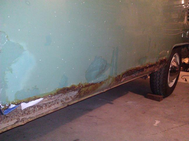

Ok now.....long rocker time. Check this bad boy out. Scary huh??!!
Should be getting my Gerson metal soon. Purchased the whole tall rocker - bpillar to vent/corner. Haven't started any cutting yet so if you have any advice please send it my way.

PostPosted: Wed Sep 28, 2011 11:35 am    Post subject: Reply with quote
Bring it on! It's not that scary. Mostly because it's not my bus and I'm not doing it.

I agree with KWZ. Its not scary,just a time consuming job. You will need a inner,possible lower B pillar,three wall pillars, and maybe C pillar,and of course the outer rocker. I just did this repair. I used a KF rocker 14" up. It was easy to install and the profile was on the money. Just take your time and I am sure it will look as nice as your short weld job.

when i did my long rocker it was a little worse than that. i used as much of the OG metal as possible but didnt keep any rust. then cut my patch panel to fit. yours doesnt look that bad. id keep as much OG metal as possible.
take your time and space your welds out so you dont warp the metal. nice job on the short rocker btw.

You did a fantastic job on the short rocker so Im sure youll do fine on the long one!!! One little trick i do while welding is have an air gun in your other hand and cool all welds the second you get done welding!
good luck and keep us posted!

Another thing I have seen done to keep the long wall flat during welding was to take a piece of one inch angle iron the length of the wall above the seam and very lightly tack it in place every few inches. It will hold the panel flat during fitup and initial tack welding. Then remove it by zipping the welds and double check your work before completing the welds.
X2 on the air gun. Allows you to quickly cool those welds off. If you have a little kid in the house, save time by giving them the air gun and have them do it behind you while you weld. Cool
