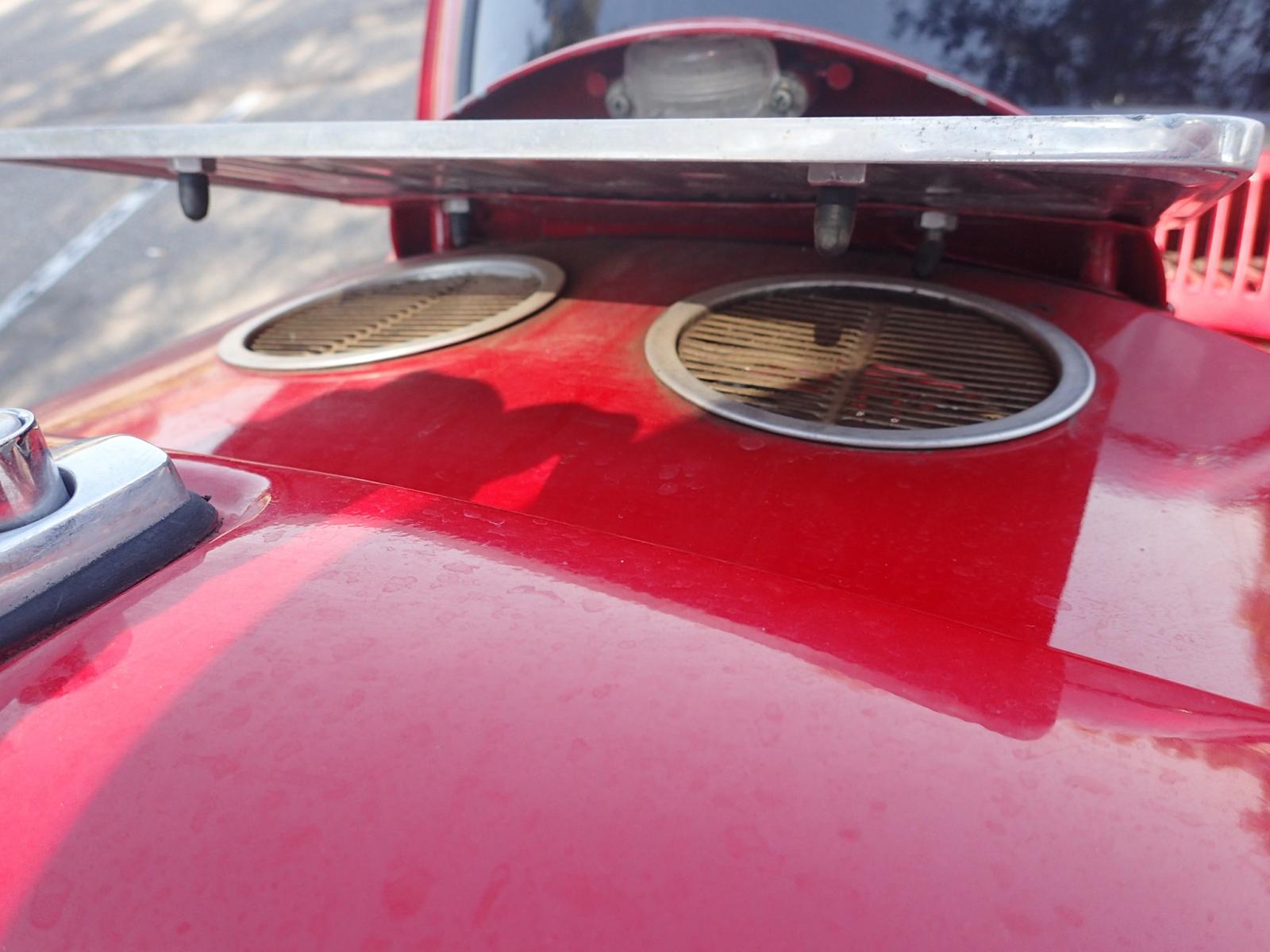

tattooed_pariah Samba Member
Joined: April 24, 2006 Posts: 2064 Location: El Cajon, CA
Posted: Wed Sep 09, 2020 1:18 pm Post subject: Re: Weber window fans |
| Lingwendil wrote: |
I'm thinking cutting some holes under the liscense plate may be a better idea.
I do have spare decklid to clean up  |
that's actually fairly common too, just saw a guy locally who found some louvers somewhere and cut holes for em..
I wasn't at the meet so I don't have any details, just saw the pic from the uploads.. _________________ -pariah
'72 Volksrod |
