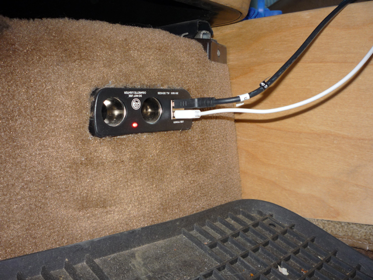

I put this under the passenger seat, got it off ebay.

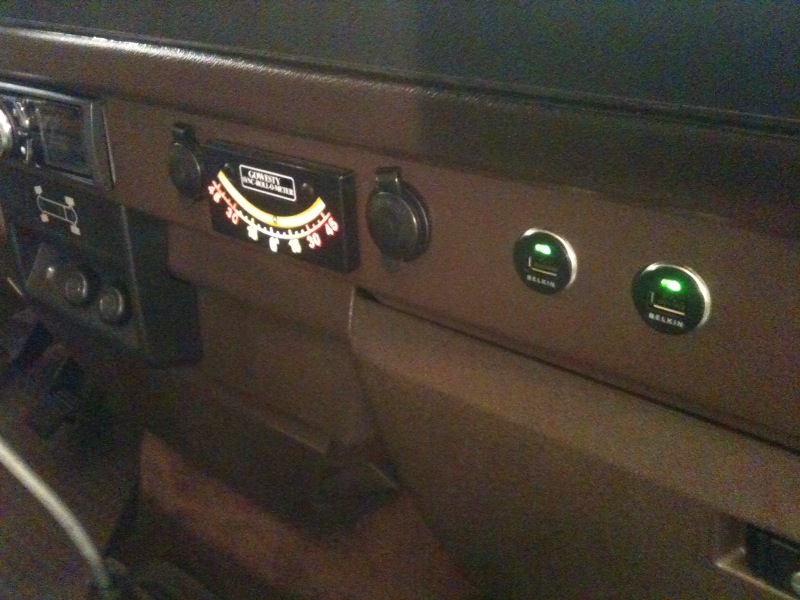

I did this:
They use a cigarette lighter outlet, but are anything but clunky Smile
Whatever USB power solution you use, be certain that it supports at least 1 amp of current. If it won't supply that, many devices won't work right (iphone especially).

squeegee_boy wrote:
I did this:
Robyn
Robyn,
Just to clarify, are those USB outlets or USB adapters inserted into a 12v output? Do you have a URL?

shepherdsond wrote:
squeegee_boy wrote:
I did this:
Robyn
Robyn,
Thanks
They plug into generic 12v outlets that I bought at Canadian Tire, but AutoZone will have them, too.
Here's the product data:
http://www.belkin.com/IWCatProductPage.process?Product_Id=489423
I do have to note that you should buy a good unit. The $3 ones on eBay may or may not support 1A of current, and even if they say they do, they may not actually do it in real life. Really weird behaviour will result, ask me how I know. Yay for spec inflation.
Stick with a name brand if you want everything to be guaranteed to work.
Edit: Yeah, you're right, r39o, if you have an iPad, you need something with more current capacity. The above won't allow you to charge and operate it at the same time.
Edit again: Ahh, here we go: http://www.cyberguys.com/product-details/?productid=51740
Belkin makes one, too, in the same form factor as the ones I currently (hah!) have: http://www.belkin.com/IWCatProductPage.process?Product_Id=525940
Robyn
